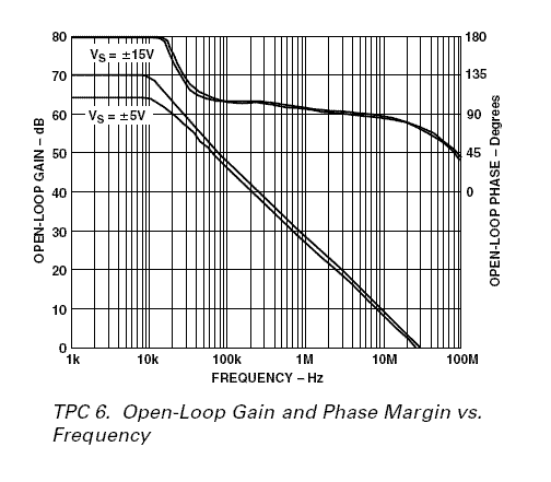

Definitely I meant high open loop bandwidth when I wrote high OLG. OLG of AD825 is almost constant through audio band.
