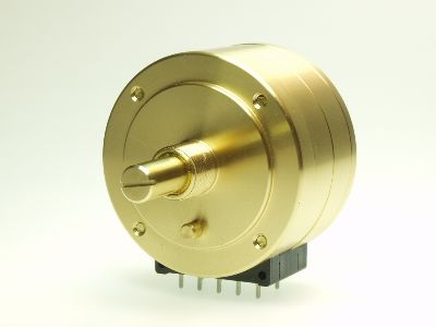

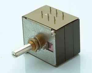

The Alps pot in question was larger than the current ones. It had a series of thick film laser trimmed resistors and contact pads on the substrate for each channel. When i tried to get them for a project recently they weren't available any more. And they never existed in a motorized version that I know of.
I may set up the pot distortion test again and document it, and measure a few samples.
I forgot the other clear winner. Vishay makes a rectangular trimmer with the bulk metal foil construction. it was on a par with any other I tried. BUT you need a screwdriver to adjust it. Vishay trimmer The sales guy told me many years ago that they made an audio taper version of the round pattern for a hearing aid company that was looking for a low noise pot. No one I have talked to at Vishay in the last ten years knows anything about that project.

That Alps pot is not what I was referring to. The older one was black in a diecast housing about 35mmX30mm I think, and had discrete steps. The specs on the pot you highlighted are pretty pedestrian with tracking at 3 dB if I read the sheet correctly. The old part was spec'd at .5 db and usually closer to .1 db. Really hard to do unless its discrete resistors.
Tokyo Ko-an also makes good pots if you can get them.
