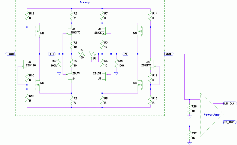

Regarding Volume Control:
Could it be an option to place the pot / stepped attenuator as per the attached schematic (U1)?
In my opinion it would
- not degrade cmmr as we do not have two pots per channel (in a balanced design)
- no interactions with the source output impedance and possible input offset currents (in a bjt input)
Regarding the interface with the power amp:
Would it be an option to place the gain resistors R16+R17 (loading the transconductance stage) at the power amp? The transconductance stage driving the cable with a high output z...
Of course, for both questions, I'm only talking about open loop designs.
Thanks, Tino

One problem I see with that is that the preamp will always have to handle the full output of the source component. That means that unless you're listening with the volume control turned all the way up, you'll have greater distortion and reduced signal-to-noise ratio than you would have with the attenuator placed at the input.
Also, if you use a conventional pot or switched attenuator, your output impedance will be much higher unless again you're listening with the volume control turned all the way up.
It's never made any sense to me to have a gain stage ahead of an attenuator.
se
Steve, I think you didn't see the location of the pot U1?
It is not at the output.
(Apart the fact that a pot at the output in fact does attenuate also the pre's noise....which a pot at the input doesn't)
This pot influences the degeneration of the input JFets.
R16+R17 are not for variable attenuation, but fxed resistors. In such an open loop design, you should load the transconductance stage, otherwise there is way too much gain.
Tino

zinsula said:Steve, I think you didn't see the location of the pot U1?
Ah, sorry. "U" is typically used to denote an integrated circuit so my eyes immediately went to the opamp symbol in the schematic.
So now that I see what you're talking about, I have a question. Are you able to attenuate below unity gain with that arrangement?
se
It is usually better and easier to use a pot at the input. Unfortunately, most pots DON'T like current through the wiper. When you use the pot as a variable resistor (shunt) then more current flows in the wiper. Many pots distort badly at certain settings, and it can be audible.
While the noise floor can possibly increase, for line amps, the reduction in input to the line stage can be very useful for higher voltage sources.

Using resistors between the sources of Jfets as an input attenuator has been the standard practice in scopes since the '60s as this input circuit from a 5A18 Tek plugin illustrates 5A18 input Its really the only way to solve the problems in that application, with a high input impedance (1 MOhm/20 pF) and response to as high as 250 MHz without significant distortion. Distortion analyzers use similar tricks to manage the dynamic range requirements, over 120 dB for a decent distortion analyzer.
