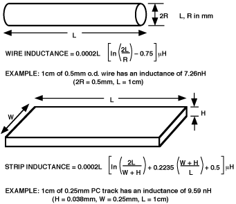

But let's be serious. Not only things like topology, fT and compensation method determine the the stability of the OP stage, but also the leads or traces to the power transistors have a marked influence, which -I'm afraid- is overlooked by most people.
If the OPS makes havoc, it's usually around 10MHz. A piece of wire of say 5cm, has a self inductance of about 5nH and an impedance (at 10MHz) of 0.314 Ohm. Given the high currents, large enough to compromise the stability.
BTW, that's why the PCB of my next amp will have 4 layers, so I can make the traces to the OP devices short and wide. Equally important, decoupling of the power rails (with low ESR caps) is also easier and more effective when using 4 layers.

Yes, I have seen the "10nH per cm" rule quoted here frequently, but this only applies to a 0.25mm wide track. Make the track 10mm wide and the inductance is a great deal lower.

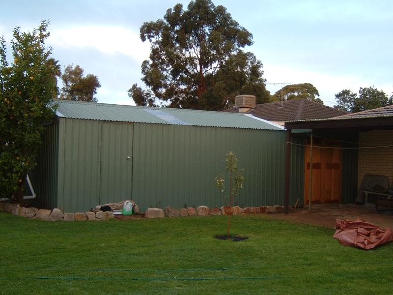

PMA said:
Do you have a photo of the amp?
Complete? No. But I have a photo of my new workshop for which the remaining 9 meters by 5.5 meters of the 15 meter long floor was poured on Tuesday. And until I get my pedestal drill press and workbench dyna bolted to the floor, I won't be able to drill the many mounting holes in the bases of the two massive 1500mm X 220mm X 85mm heastsinks either.
All will be revealed on my website, eventually........
