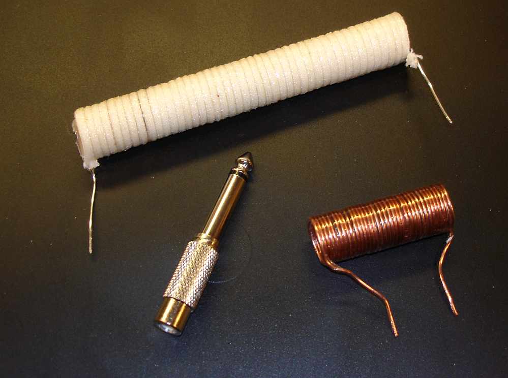

output coil
Looks great. How large is the self-inductance?
Sigurd Ruschkow said:A coil I use is one made out of thick silver wire wrapped in unbleached cotton and all this is then epoxied.
It gets fairly large as the attached image below shows.
Sigurd
output coils
Hi John,
I don't like coils either, but as long as you don't know what kind of 'rogue' speakers some people will use, I prefer to stay on the safe side.
Moreover, are there other (or better) means to keep outside RFI away (picked up from the speaker cables) without a coil and a capacitor?
Edmond
Epoxied?
What's the point of using unbleached cotton if you're just going to slather a bunch of nasty epoxy all over it?
se
hitsware said:Probably the same type of differance as between
raw silk and silk.
Completely differant texture.
Perhaps the unbleachedness
makes for a better synergy with
the epoxy ?
Well, if it's bleached or even dyed cotton, the epoxy still just seems so... incongruous.
se
1audio said:Epoxy can be too lossy. There are special varnishes with a low dielectric constant that are better for coils. the differences are quite measurable. It has been years so i don't have the details. I think the Ham version was called Q-dope.
Yeah, Q Dope's not bad. Got some nasty solvents in it though.
se
hitsware said:Yea. Maybe wax would be better ?
You reading my mind?
I've got some microcrystalline wax that was used many years ago by Western Electric for making capacitors melting on the stovetop as we speak.
se
