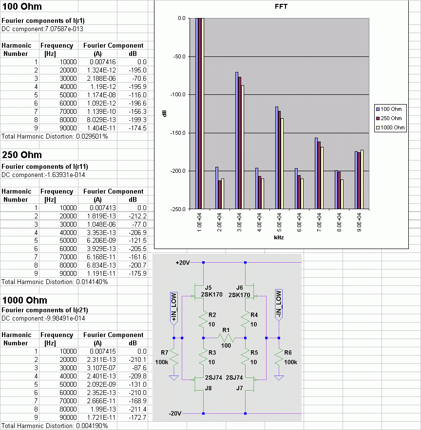

Degeneration vs Distortion
Simulated a bit...
R1 / R11 / R21 are degeneration resistors, simulated between 100 Ohms and 1k, input was always 1V peak.
Analyzed the current through R1 / 11 / 21 (= the voltage over it), so no need for source resistors and cascoding etc.
Transconductance of the FET Models seem to be around 28mS.
But look for yourself.
PS Another way would be to hold the current constant, i.e. changing input voltage.
Tino
Simulated a bit...
Tino
Hehe, I don't trust it either 😉
Here with constant peak current of 7.4mA (quite high), but with different input voltage.
Again, maybe not to trust, but as a tendency....higher degeneration seems better.
Anyone with appropriate gear to measure the same thing? Easy enough to build.....
Tino
Tino
