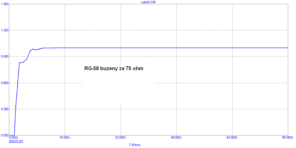

This article is confusing me. If Rsource=50ohm, Rload=50ohm, then this will make a 1/2 voltage divider.
But in this article, the original signal and reflected signal can make input~output?
http://www.ecircuitcenter.com/Circuits/tline1/tline1.htm
You have to consider twice propagation time (at least, depending on mismatch). This is the transition zone.
lumanauw said:If Rsource=50ohm, Rload=50ohm, then this will make a 1/2 voltage divider.
Yes, which is why the first article you linked had silly graphs. They showed 5 volts in and 4 volts out. It should have been 5 volts in and 2.5 volts out.
lumanauw said:This article is confusing me.
Don't worry, just keep re-reading it. I had to read Howard Johnson's book 3 times before it started to make sense to me.

Modify TLINE1.CIR for RS = 75 Ù and RL = 1MEG. Rerun a simulation and check out V(2) and V(3). Notice that the initial voltage at V(2) is 0.5 V! That's because RS = 75 Ù and Z0 = 75 Ù act like a voltage divider sending only 0.5 V down the line. But, there's help waiting at the load end. Because the load end is open, a full reflected wave occurs and the 0.5 V incident wave adds to the 0.5 V reflected wave for the total 1.0 V level. The 0.5V reflected wave travels back to the matched source getting absorbed without further reflections.
Lumanauw --
Go read the book I recommended. This will answer all of your questions.
It is a very complex topic and one or two posts probably will not clarify things for you.
One problem is that audio guys are normally thinking about things in a static way -- either DC or constant sine waves. But with this, you have to think about what is happening at each instant. It is a very different way to think about things, which is why I had to re-read the book 3 times.
As far as your question about the quote, the only thing I can say in a short posting is that you have to remember that there can be both positive and negative reflections. When the characteristic impedance of the receiver is lower than the transmission line, then the reflection will be of the opposite polarity. When the impedance of the receiver is higher than the transmission line, the reflection will be of the same polarity.
In the example given, the pulse traveling down the transmission line is only 0.5 because of the voltage divider action. When the pulse reaches the end and the characteristic impedance is extremely high, the reflection is of the same polarity and the mis-match is so great that the reflection is essentially the same amplitude.
So then the 0.5 incident pulse and the 0.5 reflected pulse superimpose to form the 1.0 volt pulse at the receiver. The reflected pulse keeps going back "upstream", but when it hits the (properly terminated) source, it is fully absorbed and "disappears".
This is why (in most situations) it is only necessary to terminate one end of a transmission line to avoid problems.

Yes. If you take an ideal transmission line with a 50-ohm characteristic impedance and terminate it at one end with a 50-ohm resistor, you will see a resistive 50-ohm impedance looking into it at the other end, regardless of its length. This is the beauty of transmission lines.
If you mis-terminate it by some amount, as with, say, 40 or 60 ohms, then you will see non-idealities at the other end which are length-dependent.
Obviously, the best scenario is for a transmission line to be properly terminated at both ends. Under those conditions, a reflection will not occur at either end.
When unable to terminate properly at both ends, one can get good transmission line behavior by series terminating at the source or by shunt terminating at the receiver.
