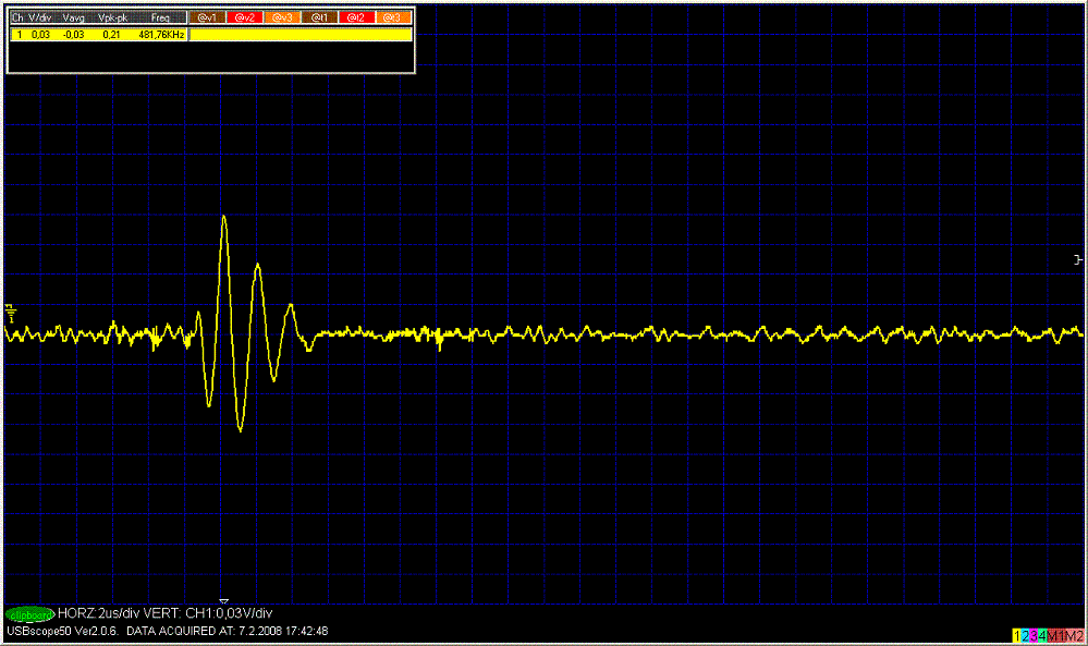

I appreciate Edmond's hard try to simulate RFI influence, but IMHO there is one of the biggest difference between real life and virtual life. I have quite a lot of time domain measurements and FFT analyzer measurements, I can post something to give Edmond a better hint.
Measured at the OUTPUT of power amp, whole audio chain, single-shot trigger. Repetition frequency is pretty variable, quite low, in audio band.

So you recommend using a pulse, but what height and width?
Although I agree with you that one should measure the whole audio chain, I have to limit my simulations to various front-ends, as this thread is about the BT and variations on pre-amplifiers, NOT power amplifiers. So, in order to stay OT, I must exclude RFI effects on power output stages.
In the meanwhile, if you don't mind, I'll complete my sims using a 1MHz RFI source (on request of Glen).

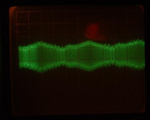

Bzzzttt.
Here is a real life result. The AM waveform shown below is what get across my speakers when a ~3 meter bare wire antenna and a tank circuit consisting of a fixed capacitor in parallel with a slug tuned inductor is connected to the input of my preamp and tuned to the frequency of the 50kW AM broadcast station less than 10 kilometers away.
All discrete BJT circuitry and no audible demodulation from the speakers.
But then again, WTF would I know about RFI immunity.
