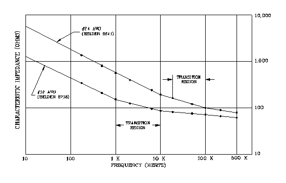

Hi, Steve Eddy,
From your Belden link, I see this picture. For lower cable, the graph shows 3 area, below 1khz is low frequency area, between 1khz-10khz is transition area and above 10khz is high frequency area. The impedance is stable at high frequency area.
Is this mean the termination equations don't work in low frequency and transition frequency area?

Hi, Charles Hansen,
Thanks for the explenation :D

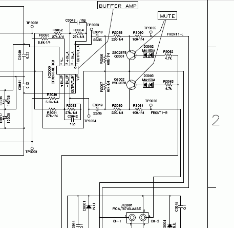

In this CD player's output schematic, after opamp, the signal goes to 22uf/35V capacitor, then to 220ohm, then to 100ohm before goes to output terminal.
Is this mean the output impedance of this CD player is 320ohm (220ohm+100ohm)? Is this source impedance (320ohm) is too high for 50 or 75ohm cable where the receiver end is not terminated (high impedance)?

lumanauw said:
What happens in a not-properly terminated line cable (where there are reflections), when the signal is audio signal.
Go back and read Bob Cordell's post 7196.
Characteristic impedance, reflections, terminations, and so forth are really only of interest to signals where the dimension of a wavelength are comparable to that of the cable. This is not the case with audio.
At least as long as we are talking about stereo systems. On the other hand, in the olden (analog) days, the telephone company did have to worry about this. Think about how long a telephone cable can be. Then if you are curious, try and figure out why the standard impedance for studio work came to be 600 ohms.

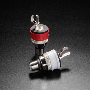

50 or 75 Ohm coaxial cables are easy to find
but not only the cable is of importance but also the
connectors' char. impedance. BNC is 50 Ohm but what
is the char impedance of the RCA jacks and connectors we use?
I have only seen one specification of char imp for an RCA connector and that is WBT's NextGen which is 75 Ohms.
For balanced connectors, I think that Neutrik's are 110 Ohms.
Anyone seen specification for char imp for RCA jacks and connectors?
Sigurd

For what its worth an RCA type connector cannot be higher that about 35 Ohms impedance (OD/ID and air dielectric, it in the math). There are some tricks to making it less disruptive but it will never be 50 Ohms or 75 Ohms. I have looked all all of the alternatives with a TDR and confirmed that its not happening. But at 30 MHz (HD video analog) its not a gross issue.
For audio this is not a big issue. And a cable constructed with two signal conductors and a shield (current premium practice for audio interconnects) is far from impedance controlled anyway.

Mentioning RCA jacks, my favorite ones are Furutech's FP-106R.
Haven't found any better.
Sigurd
