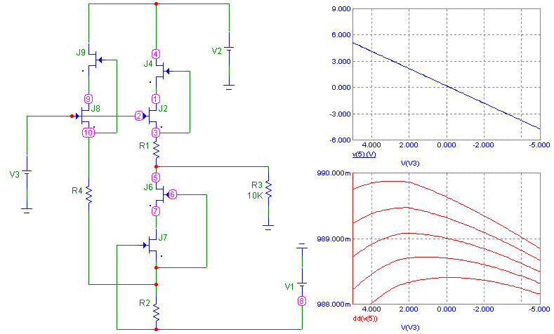

dimitri said:Thank you for your circuit idea, Scott!
best derivative is 0.9985+-0.0002
I think you got the basic idea and yes you can dispense with the extra bias sources like you did with only a small hit on distortion. When I simmed your way (optimized values) I got .004% distortion at 10V p-p, not too shabby for open loop.

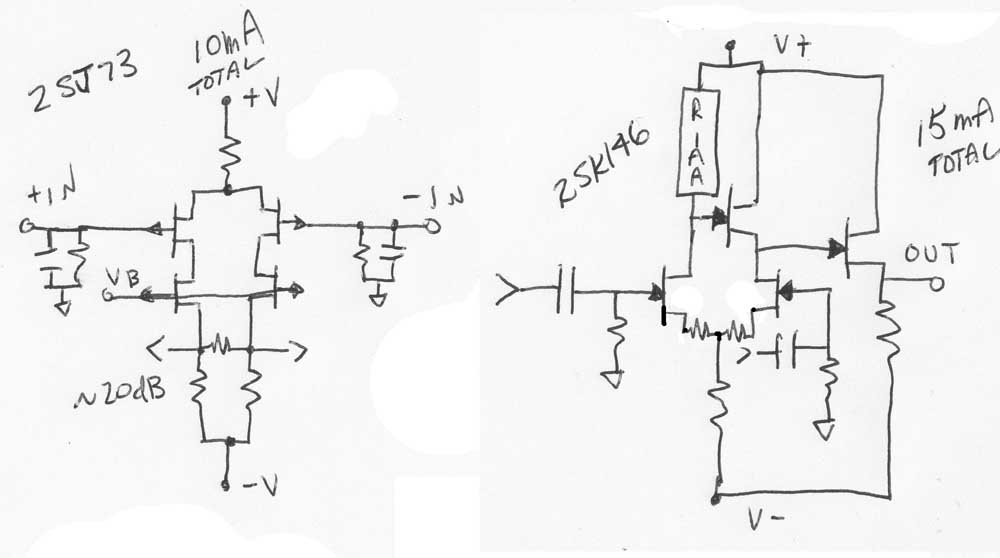

MY zen phono (with due apologies to Nelson)
A few people have asked so here is the phono front end that I have been using. I had, due to the kindness of a friend, 4 pairs each of 2SJ73’s and 2SK146’s and I had just seen Nelson’s ZEN article. So I said let simple rule the day and what do you get. As I said I wanted differential in and the P first stage and N second stage is a nod to good karma if nothing else. This set up has given me some beautiful music and to be honest it has performed as well as anything else I have owned. It was in a well shielded box with a super regulated low noise supply.
So this is my ‘ZEN’ phono front end. BTW I study traditional zen painting as another hobby.
EDIT - All high quality film caps in the signal path, no servos, electrolytics on the supplies only.
Scott,
Correct me if I'm wrong, but are you accepting balanced input from the cartridge, then using a single-ended output? It appears, though I'm not certain, that your second stage (right-hand JFET of the differential) is taking a balanced input from the first stage. There's what I'm assuming is an input arrow partially hidden beneath the degeneration resistor. Yes?
Grey
Grey
GRollins said:Scott,
Grey
Yes sorry for the less than perfect drawing, I split the phono termination (300pF and 23.7k on each side in my case) and fed differential from the first stage to the second stage. The second stage does diff to single conversion with one FET doing what I hope is a little bootstrap/cascode at the same time. The idea was to not mess with the lowest (highest gain) RIAA time constant with the output resistance of the FET's. I never actually measured the effects. An exercise in minimalism.
