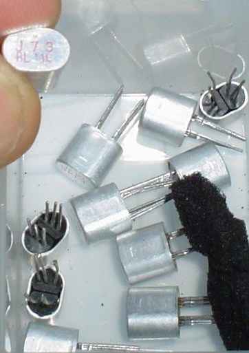

Seeing as how I (simple-minded country boy that I am) am in the process of working up a balanced-all-the-way-through discrete phono stage, it just looked funny to me. There are more examples of single-ended input to balanced output phono stages than balanced to single-ended, so tracing the signal through left me with a feeling not unlike the one you get when you reach the top of the stairs and try to step on the step that isn't there.
Yes, I see that your second stage doesn't allow for balanced out...so that would leave you building four differentials for balanced stereo use and to rearrange that would necessitate changing your whole topology. Just...I dunno...kinda wistful for what could have been, if you follow what I'm saying.
Grey
EDIT: Nelson, I agree, but the devices would have to be changed, as the 'K146/'J73 are even harder to get than the 'K170/'J74. That, in turn, might lead to other problems.
Grey
