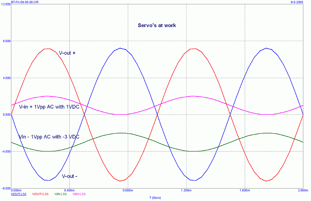

In exploring the proposals for possible servo configurations by Pavel, Charles and John my current servo configuration shows reasonable results. I have the feeling it can be taken a step further which, for me, is a challenge. There have been many examples and hints to come up with ones own solution, so I will not display the schematic. One learns by exploring and sometimes trial and error.
I have used somewhat extreme DC values which in real life certainly will not be present if devices are matched properly I guess.
