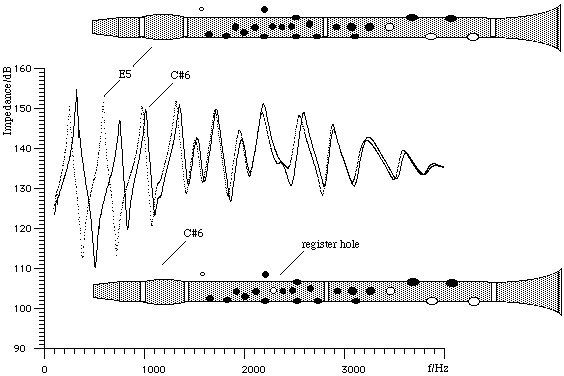

Not to pursue the off-topic too far, but Larry Klein, audio writer for Popular Electronics, was very insistent on the undesirability of out-of-phase crossover designs. He pointed out that woodwinds, among other instruments, have asymmetrical waveforms. Below is the acoustic impedance of a clarinet, taken from this website. As you can see, the centerline rises with frequency. If the midrange is out-of-phase with the woofer and the tweeter, the reproduced waveform will be very affected.
Unfortunately, the second order crossover used from the early days of audio involves these out-of-phase hookups.
