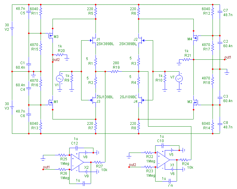

Sorry for going on-topic again. Returning to my prior remark and question if someone would like to respond....
The servo return-point has not been explored as far as I know, correct me if I'm wrong, but it seems to me that when using 2 separate servo's (in differential and common mode) the return-point in the already proposed topology to me only makes sense in the second or output stage (Mosfets), out of the signal path.
What's anybody's take on this?

courage said:Sorry for going on-topic again. Returning to my prior remark and question if someone would like to respond....
Franklin
Hi Franklin - pretty simple task:

Thanks for the proposed solution. It, however, seems to me that both servo's perform the same function. As John stated earlier and way back in this thread, one servo compares both outputs and keeps them equal and the other servo keeps the outputs near GND.
John if I'm correct the proposed return-point by Pavel is what you applied in the Vendetta and also the just released JC2, but you might have gone another route in the BT I guess.

is there a reason for crossing over the servos from out2 to in1 and out1 to in2, needing inverting servos.
Would out1-in1 & out2-in2 work just as well with non-inverting servos?

John, I'm not asking you to give away your secrets and I experience this thread as a learning and exploring one.
Pavel, my simulation results point out that the 10K resistors at the output of the OA should be 1K to give proper results. I may add that my topology uses different resistor values and output Mosfets. Also that there there are more ways to apply servo's in the second stage and out of the signal path; probably the route John took or a combination of both first and second stage servo return points.
