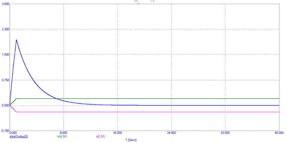

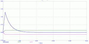

OK, I see now exactly what is happening.
The mid-band gain of your circuit is slightly higher because you are altering the amount of local degeneration of the input stage.
The low-frequency gain of my circuit is changed because the "servo" is not just sending back DC, but also low-frequency AC. There is more AC gain at the gates of the cascodes than at the sources of the input stage. If you want to restore the low-frequency response and still use my circuit, either increase the time constant of the "servo" amp or decrease the gain of the "servo" amp (to compensate for the increased gain of that input node).
Charles, I am aware of this. The hypothetical question might be which of the two DC "injection" points should be used. I assume there are pros and cons in both cases. What would be less perturbing, to shift FB point, or common gate point?
BTW, I tried to decrease servo gain in "your" connection.

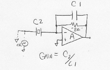

First let me apologize for letting a few comments get “under my skin”. I had come with what I thought were a couple of interesting circuit “thought experiments” that I went ahead and tried out. So with a more simplified circuit let me try again. The question was, “ how do you make a low gain, low noise line stage, in a conventional sense i.e. with feedback?” By low noise I mean preserving 1-2nV even at a gain of -1. I came across this while experimenting with some old ideas involving charge amps and microphones. Drawn simplified I hope it’s clear that I’m talking about putting the transducer into a virtual ground and the bias resistor can be large enough so that its low frequency noise is less than the op-amp’s 1/f. Peter Baxandall wrote an article about using loudspeakers as microphones where he discussed reciprocity at length. Well Q=C*V and reciprocity applies just as well to capacitive transducers.
I’ve build several of these and they work fine. Short of taking them to our MEMS mike lab and putting them in a B&K test chamber I can find no difference in performance from the normal JFET circuit except that the distortion holds up rail to rail. I’ve compared frequency response with a spark gap excitation and made some test recordings.
The real point is that A could be any gain cell even John’s 6 device one. Biased up for more open-loop gain so it acts a little like an op-amp and using capacitors in the 100’s of pF range it should work fine. I have tried it with my FET/op-amp combo. Who need’s a 2nV line stage? I don’t know, but people do make line stages with variable transformers at great expense. The input load is no worse than a couple of meters of cable. The amp can easily be made cap load insensitive at high frequencies
Just a little thinking outside the box. BTW except for the 'feedback' cap (which can be as high a quality as desired, it's small) there are no caps in the signal path, no source resitor bypasses none.

Scott, your model still implies a linear source cap. If not, then what? Please read Erling Fredricksen's paper on cap loading of microphone capsules. IF your setup actually bypasses the problems with cap loading, then OK. If not, maybe you are generating some amount of negative capacitance as an active load for the mike. Just the right amount would do amazing things, but it could not be changed, just to adjust the gain, then. Please read the exact paper in the B&K Technical Review on the B&K website, aka 1996, by Erling Fredreksen so that we get on the same track.
Personally, I like your approach, but it should be problematic, according to Erling.
Also, I do not believe that it is any quieter than any other approach, because the resistor is still the fundamental limiting component at low frequencies, and the capsule damping at mid frequencies for low noise performance. This is also brought out in the B&K Technical Review
I was of the impression (perhaps wrongly, school was a long time ago) that a 50 Ohm resistor and a 50 Ohm reactive impedance produced the same amount of noise, with the limitation that the noise of the impedance must be measured at the frequency where the impedance (in this case) equals 50 Ohms.
In other words the universe forces Kelvin noise on us proportional to bandwidth and impedance regardless of type. Am I incorrect?
Caps and ideal inductors do not make noise, BUT they create conditions where noise can be seen that is intrinsically in resistors or any active devices.

Thanks for showing a different way of using a servo configuration which works. Would it not be more effective to use two different kind of servo's:
One servo which compares each output and adjusts them to be close to each other and another servo tries to keep the average of the 2 outputs near Ground (words of wisdom 😉 )
Maybe a combination of your take and the one Charles has suggestged might do the trick?
BTW: how do I get the DC component of Voltage sources in MC8 to supply different voltages. If I change the DC component of one Voltage source, the other changes with it. Quite strange.
As ever, thanks.
"Sigh" John I've read all the papers, they are fundamentally about open loop capacitive transducers this is a short circuited transducer. The paper you mention is a research paper, there is no evidence that it is used in any product certainly not in any audio related one. Most of their products predate 1996 by many years anyway. The cancellation is found by solving an elaborate mathematical model and taking careful measurements of capsule deflection. The cancellation is a very sharp suckout not unlke neutralization. And again, 160dB is where you measure 'knock' in jet engines.
Actually the 'A' weighted contribution of the resistor noise is much less that one thinks. I never said the circuit had less noise just there are no additional sources.
And just to be pedantic, I quote a little physics (couldn't help it).
"The voltage variance at a capacitance C with a noisy resistance in parallel is kT/C, even if the resistance is infinite."
Put a "battery" in series with "sine source", for example. Voltage of any battery is independent, you can set it for each of them.
Also, you might like to try pulse/square source, with long pulse duration, like one minute, and observe DC settling. Again, you may put sine in series. Do not forget to make sine source output impedance zero.
Regarding servos, John has already replied.
