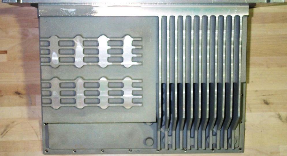

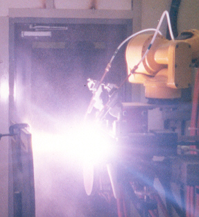

Hog-out Aluminum Chassis
Perhaps John, Charles and/or Nelson might be interested in this. We had a recent program where we used an aluminum chassis machined from a solid block (much like the Blowtorch chassis). It has an integral 19" rack front plate, and heat sink finning on the bottom. It was about twice the cost of John's Blowtorch chassis. We decided to get a quote for a casting. It turned out to be just $1800, with all the added machining and tapped holes. Break-even quantity after paying for the tooling was only 22 castings. The casting vendor was Armstrong. I'll try to find out the alloys used, but there are definitely "aircraft aluminum".
Best, Chuck Hansen
