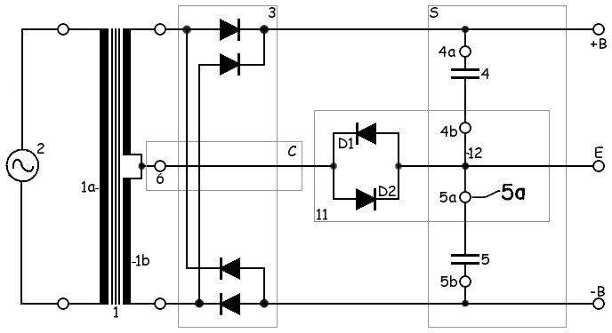

I posted the attached image taken from US Patent 4,555,751 in an old thread, thought the response might be of interest.
Regards
James
Elso Kwak
Powersupply Post #23
Hi James,
John Curl uses a 1 or 2 mH choke in place of the diodes D1 & D2 for his powersupply upgrade for the Mark Levinson JC-2 preamplifier. I forgot the exact value. I tried this too and it works as the sound improved.
Regards
James
- John Curl's Blowtorch preamplifier
