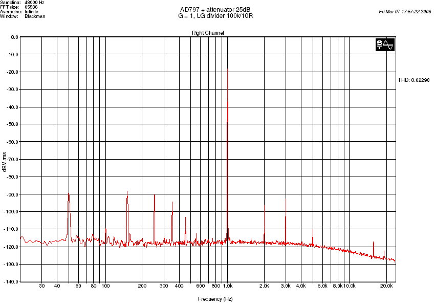

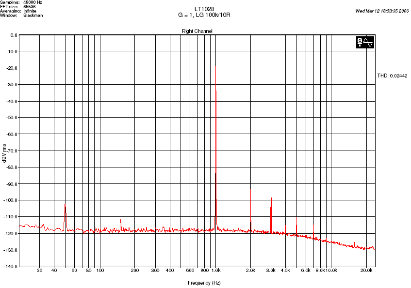

PMA said:I can share the LT1028 result.
A hint: signal gain = -1, noise gain = 80dB.
I have to admit, this charades are sometimes tiresome. So, let me summarize and correct me if I'm wrong:
- You are using in your evaluation a metric that you cannot disclose or otherwise specify
- You cannot disclose the test circuit and anything about your measurements setup.
- You are disclosing the results for LT1028 in an -1 gain, inverting configuration, but without disclosing the load and the signal amplitude.
- You are using a concept ("noise gain") which, as long as it's not part of the LT1028 datasheet, needs to be consistently defined for allowing any comparisons.
Based on my understanding of this concept, let me make a wild guess. The noise gain is the reciprocal of the attenuation from the output of (or any feedback loop) to the input. This attenuation is Zi/(Zi + Zf). So the noise gain is (Zf + Zi)/Zi. If I am correct, why do you think such a high noise gain setup is relevant? It certainly doesn't help in your mesurements. And are we are talking here low (80dB noise) vs high frequency (-1 voltage) gains? Sorry for the speculations...
Based on the above, you are claiming that OPA211, LME47910 and LM4562 have poor performance. Set aside my own recent experience with these two opamps (which I am ready to share with anybody interested, to the ultimate detail that I am aware of) and which doesn't match yours, what do you think it's making you statements credible?
Edit: I've noticed you disclosed the load of being 1kohm, thank you.
