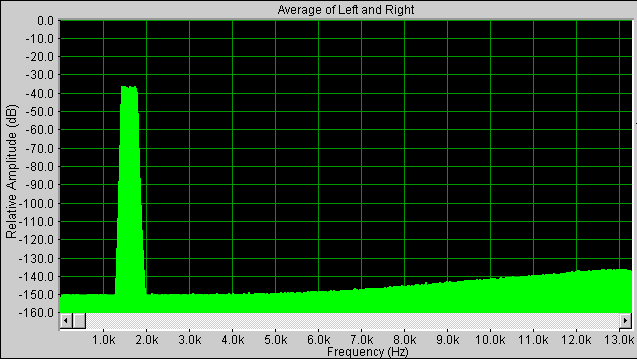

BUT - try narrow band noise. THEN the distortion threshold is much lower, and you easily hear something like -60dB to -70dB of 3rd harmonic.
This seems to back my results in these matters. I found narrowband, 1/3rd octave filtered noise to be very revealing (to the ear) to any kind of artifacts and distortion, better that steady state sine or multitone. With this test signal (see FFT per attachment) I could easily nail down the "biting quality" of my small coaxial tannoy's horn, at the start of its transducing range. It really gives an broadband intermodulation/distortion floor that sticks out, sonically. I wish I had that test signal when I bought the speaker (then I would have bought them no more).
To my knowledge pulsed/modulated band limited noise is also a known good test signal in the measurement camp ;-)

This seems to back my results in these matters. I found narrowband, 1/3rd octave filtered noise to be very revealing (to the ear)....
Hi Klaus. How did you generate that signal?
