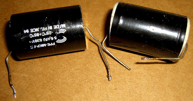

I've not had any failures of Solens and that includes nearly 1000uF per channel in my tube amps, meaning they run at something like 575V. I have had some that were quite hard to solder. For the record all of my Solens have come directly from Solen in Canada, so I doubt there's a counterfeit problem in my case.

I just happen to have 4 82uF 400V Solen MKPs awaiting use in a tube pre supply in the very near future. I beleive they are 10-15 years old. They served several years in a X-over earlier in life. They may have seen storage temps at least 125 degrees (My Az Garage). So naturally after reading this I had to give them a look...
I have a simple (handheld) Wavetek Cap meter. They are all 79-81uF 😀 Well within their 5% value rating...

My particular units have a very good finished appearance (black outer and grey epoxy), and are model/part# PB-MKP-FC. Also printed on them is "Made in France". I have had a handful of other sizes in the past from the same source and have not detected the issue under discussion. I'm happy with them so far 😀
I use Mundorf also when need be... I'll keep this in the memory bank somewhere. Thanks for the heads up though Mr. Curl 😉
Mine were sourced locally from a small independent shop.

This is a very curious failure mode for a film cap. I just ran out to the Calibration Lab and put a resistor decade in series with our 10uF MPP capacitor standard (10.00uF D=0.0012, ESR=0.02 ohms). I added series resistance with the decade and measured C and D with our HP4263A, at 120Hz 50mV, 120 Hz 1V and 1kHz 1V. The 1kHz 1V measurements are below (the other 2 ranges are similar):
R = 0 C=10.00 D=0.007
R = 1 C=10.00 D=0.069
R =10 C=9.99 D=0.622
R=100 C=9.86 D=Out of Range
Even with really large values of ESR the capacitance shift is less than 2%.

Hi Charles, why don't you just call the cap manufacturer and ask him? He must know about this, as I am not the only example. In fact, you might call Jam (unfortunately a banned member from this website) and ask him about his experience. The manufacturer has not called me yet about this problem. (Mr Blunt) 😉
I keep circling back to the idea that--and yes, this is contrary to the information posted on the Solen website regarding the construction of the cap--what if the plates were zinc instead of aluminum?
If the plates are (or were at some point in the past) zinc, then they'd be more chemically reactive than aluminum. If the zinc were to react with oxygen, just to pick something at random, then you'd have your choice of two failure modes:
--Surface corrosion, leading to a "bulking up" (due to most any zinc compound being physically more volumetric) of the conductive layer which would lead to the plates being farther apart. Bingo! Reduced capacitance.
--Total corrosion of the plate, leading to a reduction of effective plate area. Again, reduced capacitance.
Given that the layer is going to be quite thin, I imagine that the second mode would be more likely.
John, if you happen to still have one of those caps, could you cut it open or unwrap it to see if there are any visual clues?
