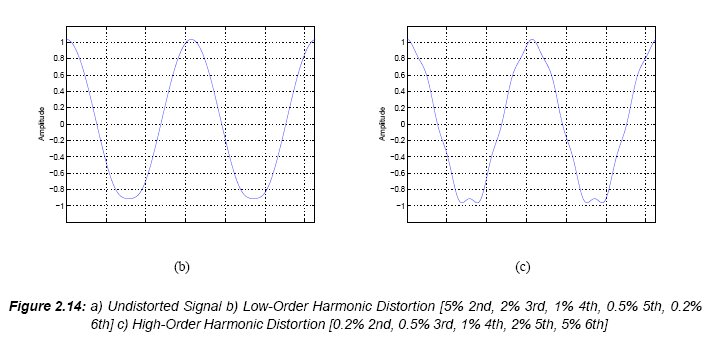

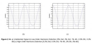

KSTR said:
According to this paper, Moore et al even come closer.
The real "problem" is that virtually nobody in the industry (both the audio test gear and audio reproduction branches thereof) has adopted these new and way better sound quality metrics (and quite complicated to derive), at least to my knowledge. A single number THD value and even the full spectrum (mag/phase) it was derived from is close to meaningless if one doesn't know how to correlate that to the perceived sound quality. That's where Geddes/Lee, Moore etc spent their efforts in: a more useful and more realistic interpretation of the given data. There is still a lot of work ahead, say correlation of measurements of stereo channels to perceived "imaging", for example... it will be done, sooner or later.
- Klaus
Statistically, people generally find low/even order distortion products less audible and less objectionable than odd/high order distortion products.
Since we can measure an amplifiers distortion spectra, the blanket assertion that “In truth, no one can fully correlate measurement with statistically based listener preference” (uttered without the necessary caveats) is definitely not “in truth”.
WRT to the utility of THD measurements – I fully agree that a THD figure by itself is pretty useless for predicting the “subjective perception of nonlinear distortion” (and therefore as a figure of merit for a power amplifier) – provided that the distortion products are above the threshold of audibility.
If I build an amplifier, plug it into the distortion analyser and measure no more that 0.001% THD at all power levels between 20Hz and 20kHz, what predictions (based on scientifically demonstrated thresholds of audibility) can I make about how the amplifier is likely to "sound"?
