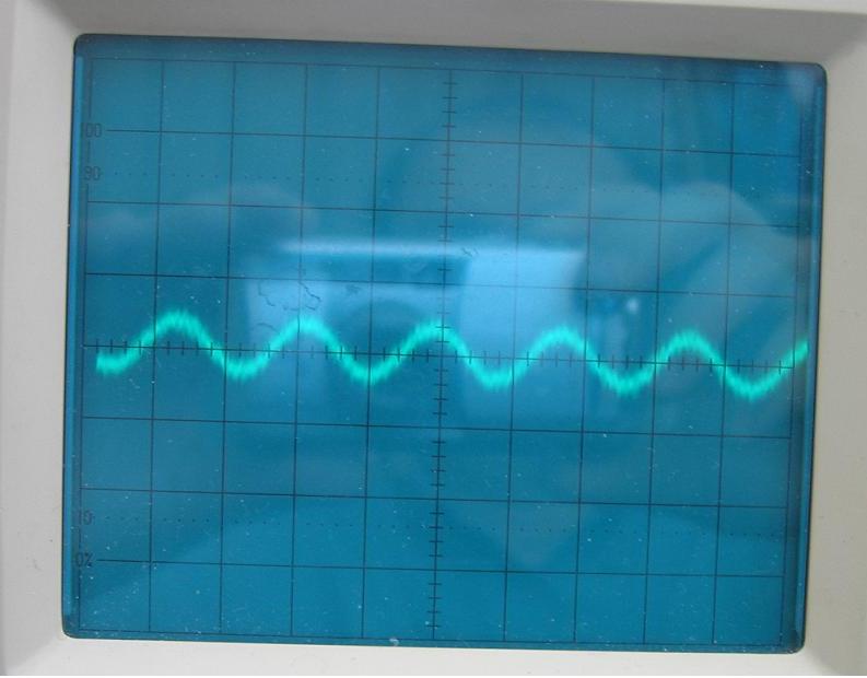

-80dBFS 1kHz dithered signal from analog output of a good CD player, measuring bandwidth 20MHz! Not bad, is not it?
Scale is 1mV per 1 vertical div, Vpeak is 330 microvolts.
