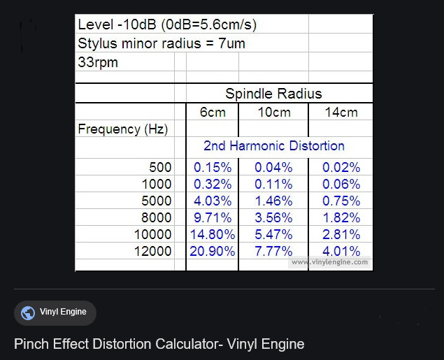

On the other hand, distortion because of the pinch effect, i.e. pushing the needle tip out towards the middle of the groove because of the radius of the needle, is quite substantial at 10Khz at his modulation level.
See image below for a -10dB signal and a 7um elliptical needle. This effect will of course contribute to increased crosstalk. For a 17um spherical needle it would even be much worse.
So the deeper you go, the more worms are escaping the can and the more complex it becomes.
Crosstalk measurements to get a better insight in the elastic/plastic surface behaviour will be hard to separate from other contributors like Cart motor imperfections and Pinch effects.
