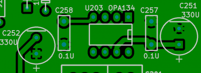

I've rolled about a half dozen opamps into the Azul headphone amp, which is a lot like Whammy except the output stage is an LH0033 hybrid rather than a discrete-transistor buffer. None of them oscillated or exhibited unwanted behaviors; their transient response was consistent with a second order linear system whose damping factor zeta is about 0.85.
Yet I heard (small) differences. The one whose sound I liked best was a JFET-input unit designed by George Erdi. The mighty all-bipolar, Silicon-Germanium OPA1611, wasn't quite as pleasing. Nor were the other opamps I tried.

What power supply and filter caps, if one may ask?
Each of Azul's two supply rails has two voltage regulators in series, the old pre-regulator then final regulator idea. Final out is plus/minus 15V.
Each opamp IC has two 100nF film caps plus two 330uF electrolytic caps, laid out right next to the supply pins. One film and one electro, per rail, per chip. Output stage has several of each cap type per rail. See Gerber snippet attached; it's the DC servo opamp for the right channel.
film cap Mouser P/N 871-B32529C1104J189
electrolytic cap Mouser P/N 667-EEU-FR1E331B
rectifier bulk filter cap Mouser P/N 647-UBY1V302MHL (4 total, 2 per rail). 26 milliohms, 4.26A ripple per cap
rectifier diode Mouser P/N 863-80SQ045NRLG . Brawny Schottky with concomitant high leakage; I don't care.

All those electrolytics may dominate the feedback loop response of the associated regulator, no?
