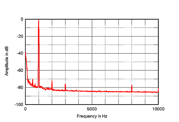

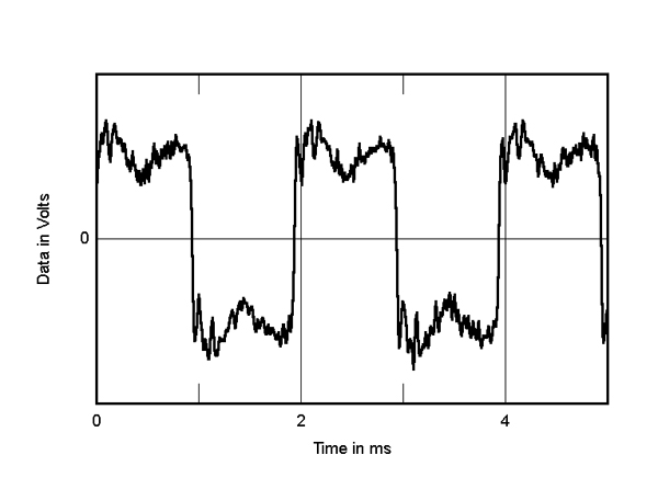

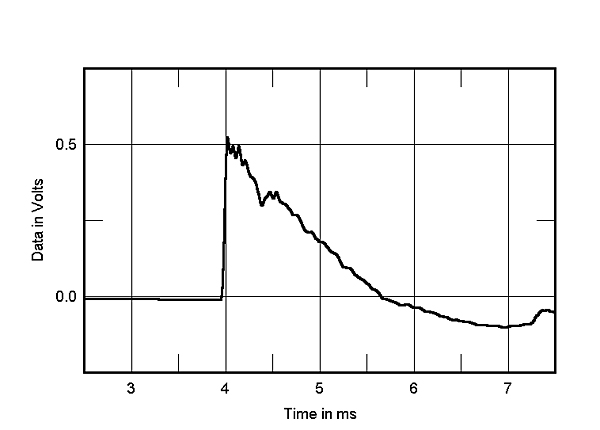

As new as 2012. You could point to the Stereophile review: Quad Reference ESL-2805 loudspeaker Measurements | Stereophile.com

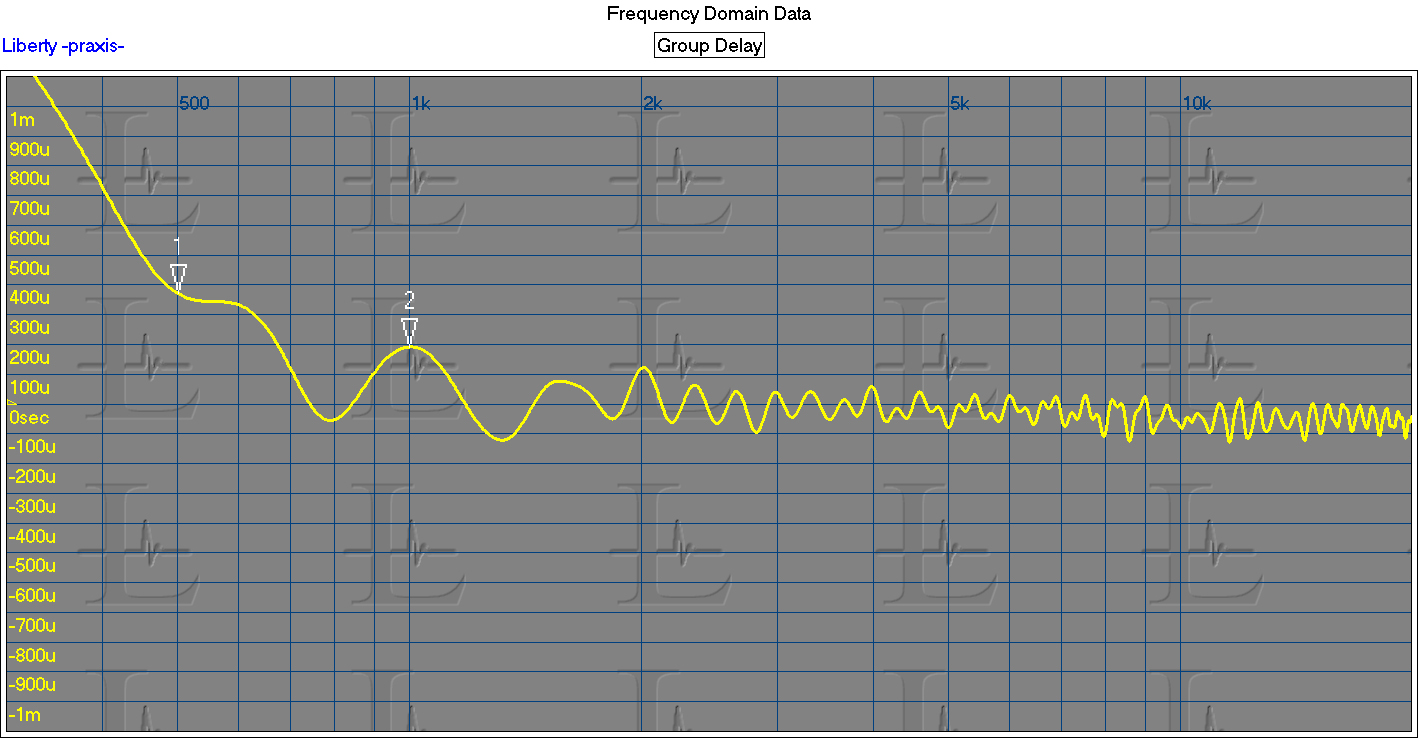

I have already posted this group delay curve of a Moonaudio speaker, time aligned with DSP.

But the Quads do a fine job with square waves!
<snip>
Not just with square waves but with music !

Frog, my comment was about Richard's very annoying habit of posting half baked and without context graphs/measurements without indicating the source, leaving the impression these are his own contribution/evaluation.
As he stated "an example of a speaker that can do square waves without DSP"and showed the graph of a reproduced square wave, in which way is it "half baked" ?
Of course we should include correct citation, but obviously we all forget about it sometimes; in this case there was no indication that RNMarsh had measured it himself (btw most folks following this thread know what Stereophile measuremtns look like).
