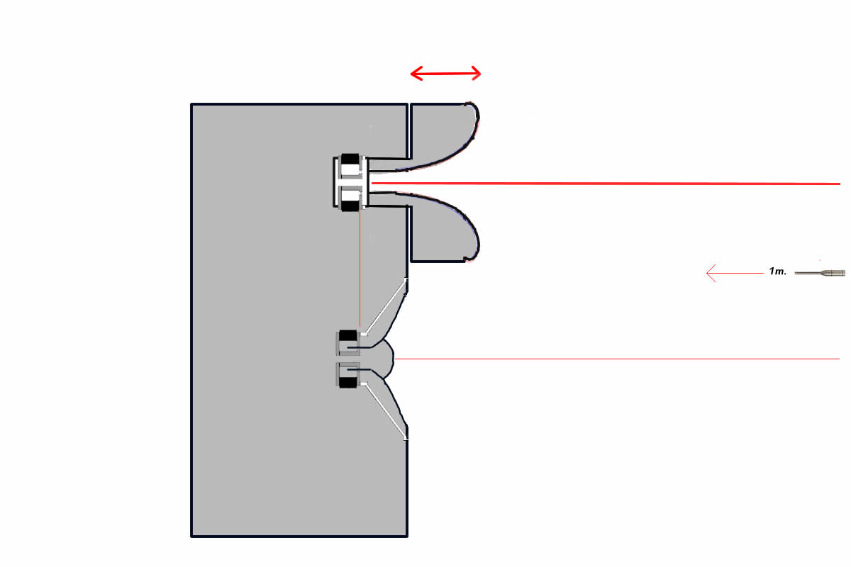

I seems a useful way to time align, have you looked for square waves at other frequencies and/or places?
Of course. One of the reason I stick to 24dB/oc slopes for my filters. Butterworth, Tchebychev or bessel, depending on the circountances and drivers.
About places, the acoustic is indeed a complex situation. I take a lot of care to get speakers having the same directivity curves at the crossing frequency. IE Horns.
Working in free air (Or anechoic chamber) helps a lot to get rid of the room's resonnances. The mike has to be placed in the ideal situation (see attached)

I can get some good looking traces, if I find a good position then move the mic away whilst keeping it in the same vertical and horizontal planes the shape comes and goes
Moving out of the near field will cause a lot of room reflections to interfer with the direct sound from the driver. You wont be able to tell much about the driver out in the far field.

Yes, I can get some good looking traces, if I find a good position then move the mic away whilst keeping it in the same vertical and horizontal planes the shape comes and goes, it makes me wonder how useful it is as a measure, other possibly for crossover alignment.
You have to set a single pulse. Or work in free air or anechoic chamber.
You can do-it in a decently damped room with some habit, as said Richard, with close miking. Look at the front edge to have-it as vertical (fast) as possible.
