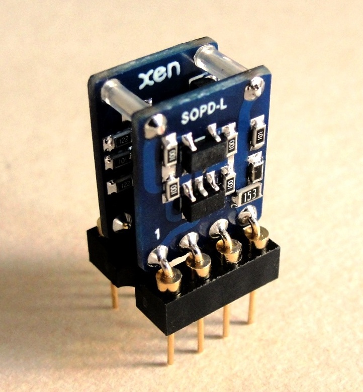

I use 0.35mm 4% silver.
Down to 0603 is no issue at all.
0402 is a bit tricky to hold.
See :
https://www.diyaudio.com/forums/att...pamp-dip8-footprint-190226-sopd-2-trimmed-jpg

Very nice Patrick!
