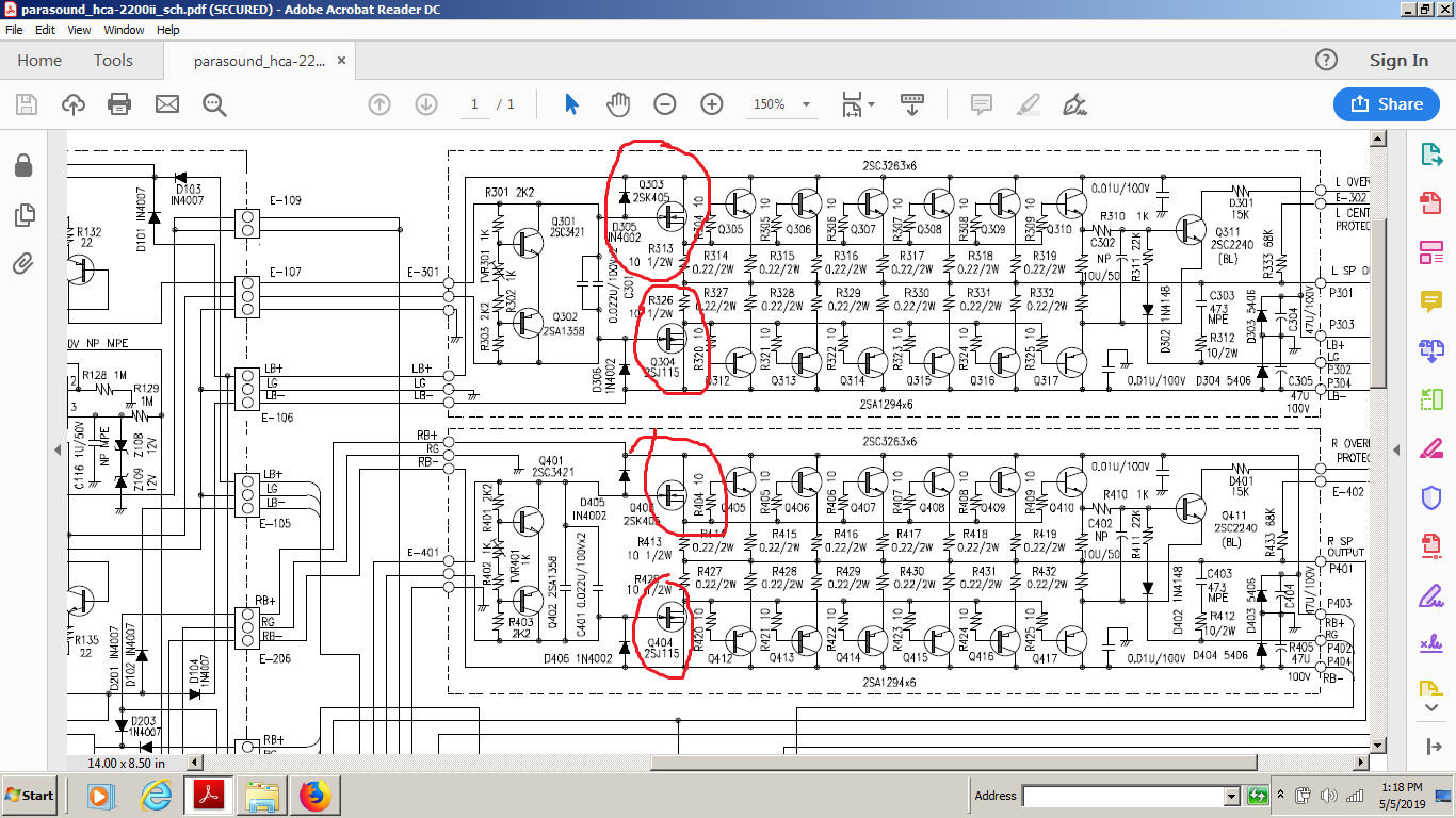

WHO was the first to use a mos-fet transistor to drive bipolar transistors to circumvent the BE capacitance that lowers the slew rate in the final stage?

I don't know who used complementary power fets for drivers first, I just adapted what Parasound was already using in 1989. However, in 1976, I modified a circuit for Mark Levinson which allowed bipolar transistors for the output, and I drove them with complementary jfets. This became useful for the LNC-2 crossover, I believe that it was used for that.

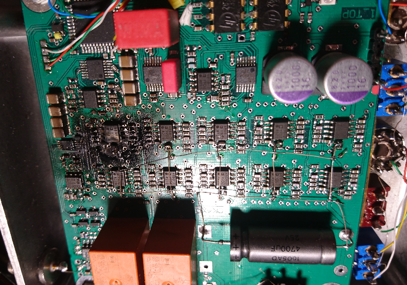

Those high priced AD op amps touch an open wound here currently. The AD4898-2 used to be a good deal, but now at €7.50 per pop it starts to hurt. And I noticed in my 10 * 4898-2 parallel amplifier that the noise went up from 200 pV/rtHz to 600 pV at 1 MHz. Unacceptable. I found out that this was nothing but the skin effect on the board. I soldered in some parallel wires, et voila, effect gone.
But then I measured an object that could deliver current without end. I mean, really without end, with Lithium batteries involved. The aluminium case was fastened with 6 screws, but the stench, OMG. I took it out to the balcony to open. Near one of the ADA4898-2, the board was black as coal. Wires were molten. I had soldered one of the wires to the input side of the that wet slug tantalum cap. Now, I'll send another €80 to digikey to bring it back alive 🙁

No, it was not the 4898's fault that it died (very probably I cannot trust the other 9 that did not produce a crater in the board). I measured the noise of 4 18650 Lithium cells, about +16V with 30A short circuit current. I was not happy with the noise of an IF3602 amplifier that was supplied from the Lithia. 350pV/rtHz for one FET. Worse than the data sheet, even with more drain current. Not bad for a FET, and respectable 1/f corner, but definitely worse than specc'ed.
16V/30A or so into an op amp running at +-6.5V is a bad thing. mea culpa about that shorted input cap. You can see the bad wire in the photo. It is kinda unfair that it survived.
The ADA4898-2 can get burning hot when one of it's inputs is open. That would belong into the data sheet. At least it won't die on the spot.
mea maxima culpa. Gerhard
