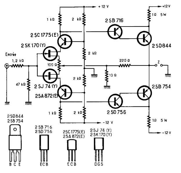

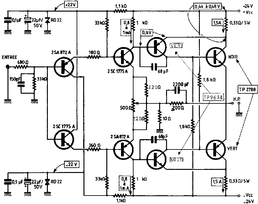

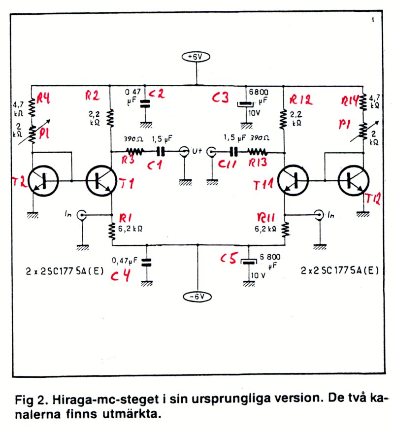

This guy did the same at the same time with you in Europe...It seems that he was a bit more successful in getting to the essence of an audio amplifier, as you can easily find low noise pnp tansistors which are also lower noise than their fet counterparts when driven by low source impedance...
So he used 4 pnp transistors for both channels...If there's any significant DA due to the output capacitors, than maybe it's welcome to reduce high freq resonances in mc cartridges 🙂
He started as you with complementary input fets, but he was quicker at realizing that you can get the essence in a much simpler way:
I think that there's no simpler design ever made for the purpose and there are more clones of his designs than any other class A designs for a reason even though it's quite an expensive amp to manufacture due to large heatsink needed and capacitors to compensate for the large currents and poor PSRR.
Nothing is for free in this world, but i can build a Hiraga anytime with available components.
As you can easily see, his design don't need any zobel network or inductors at the output either as no class A amp ever needed such things being inherently stable with minimum gain.
And it's current feedback too!
As this is a super sized version of Hiraga made later in the diy world, and the only version of Hiraha i ever listened to, i can surely tell that this is a hell of an amp and it sounds indeed very well.

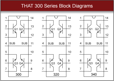

...that happened to be launched more than 40 years ago when only lm344(194) was...OR NOT??? available and it wasn't as low noise as the lowest noise bipolars, but...
What a coincidence THAT bipolar transistors made their way t-t-t-to our world!
THAT Corporation 300-series Low-Noise Matched Transistor Array ICs
The NPN version of it!!!

And the Hiraga pre pre can be used also in balanced configuration which will improve the common mode and will remove entirely the output capacitors so that JC can smile too 🙂 You could thus use a single supply for even greater PSRR.
What a coincidence THAT bipolar transistors made their way t-t-t-to our world!.....
Yes, in our case that was MAT -01 -02 -03 -04, whatever.
I have even used a few in a low noise preamp. That high-price stuff
can survive dozens of years in the drawer ( see the date codes printed on them)
