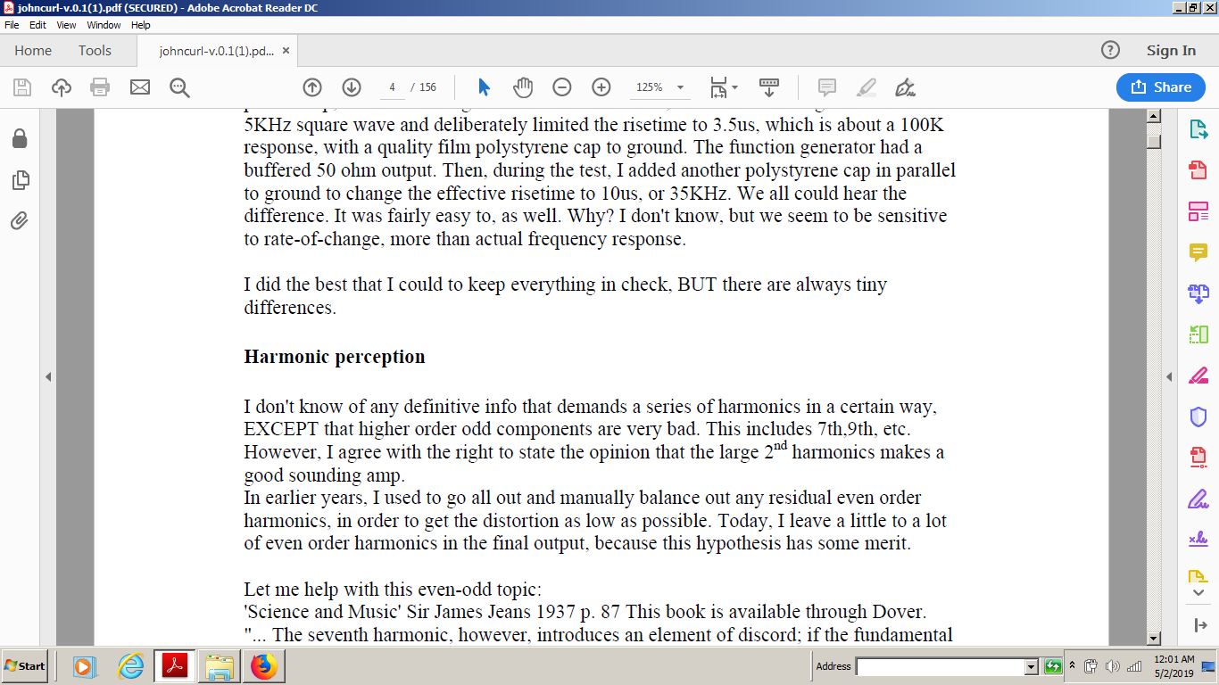

Dreamth, you appear to not understand dielectric absorption (DA) in caps. This does not measure effectively with sine waves. You need special test waveforms. Do you know what I am talking about?
I know ...I was just reading your pdf document and i got over your slew rate test (3.5 us...10us), but capacitors charge discharge process is faster than sinus waveform which the actual music is, complex, but still sinus and anyway the highest slew rate of a sinus waveform is in the zero crossing region where the dielectric absorption is minimal. Maybe it's just QSC which are stressing their coupling capacitors at the highest levels possible and still their distortion levels are very small.

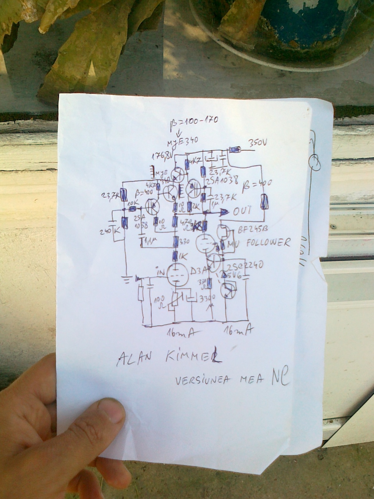

Please look at an older phono preamp i made in 2014 and see the measurements.At the time i changed a valve stage with a higher transconductance stage based on transistors and the response changed from max 10khz square wave to 20 khz square wave. I shouldn't hear the difference but i did, just that i modified the amp's slew rate, not the signal slew rate .I couldn't explain that either. The sinus signal tests modified visibly on the scope at 480khz with the last modification.It had no feedback so it was easier to work on. The Problem:
I was measuring that response through an anti-riaa filter, two coupling capacitors and a passive riaa filter:The input signal was 5 v rms i think...i don't remember exactly i just used a home made generator.
https://www.diyaudio.com/forums/analogue-source/255149-unu-pnono-riaa-mm-preamp.html#post3935638 If you're curious you can see what i did later changing the riaa filter .The square freq response was identical but the sound changed.It sounded a bit more cleaner but lost some vibrant effect, it was lifeless.

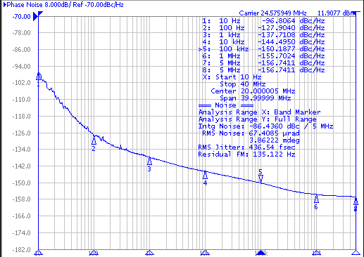

Getting back to some technical topics.
Here is a real measurement of Kyocera K50 series 24.576 MHz XO performed by an Agilent E5052A (courtesy of member davecandialex).
This is a $2 SMD XO.
164283d1269656389-xo-analysis-k50-png

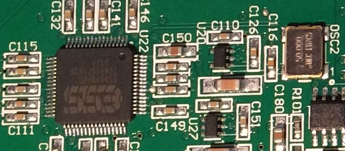

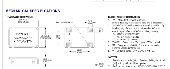

I also looked at close up pictures of the Benchmark DAC3 PCB and read the markings off the 6 XOs and they are all CTS CB3 series parts.
https://www.ctscorp.com/wp-content/uploads/2015/11/008-0256-0.pdf
Cost is around $1.70 from DigiKey in qty 1. Does not even specify phase noise vs frequency other than a 12kHz - 20MHz jitter spec.
Maybe the clock obsessed can explain how the Benchmark be any good using such pedestrian oscillators.
Perhaps it's yet another BS narrative created by those with a vested interest in selling clocks or differentiating their product.
Markings of the CTS chip you linked to attached below. Doesn't look anything like the clock marking in the pic I posted.
The clock in the pic only has two lines of print. There is a decimal point in frequency rather than an M, etc.
It does appear to be a different part. It's clearly visible in the pic I posted, though.
You'll also note there are more than 1 version of the markings, and the OSC2 has the M in it in the pic I posted. It's possible some of them are older or from a different facility.
