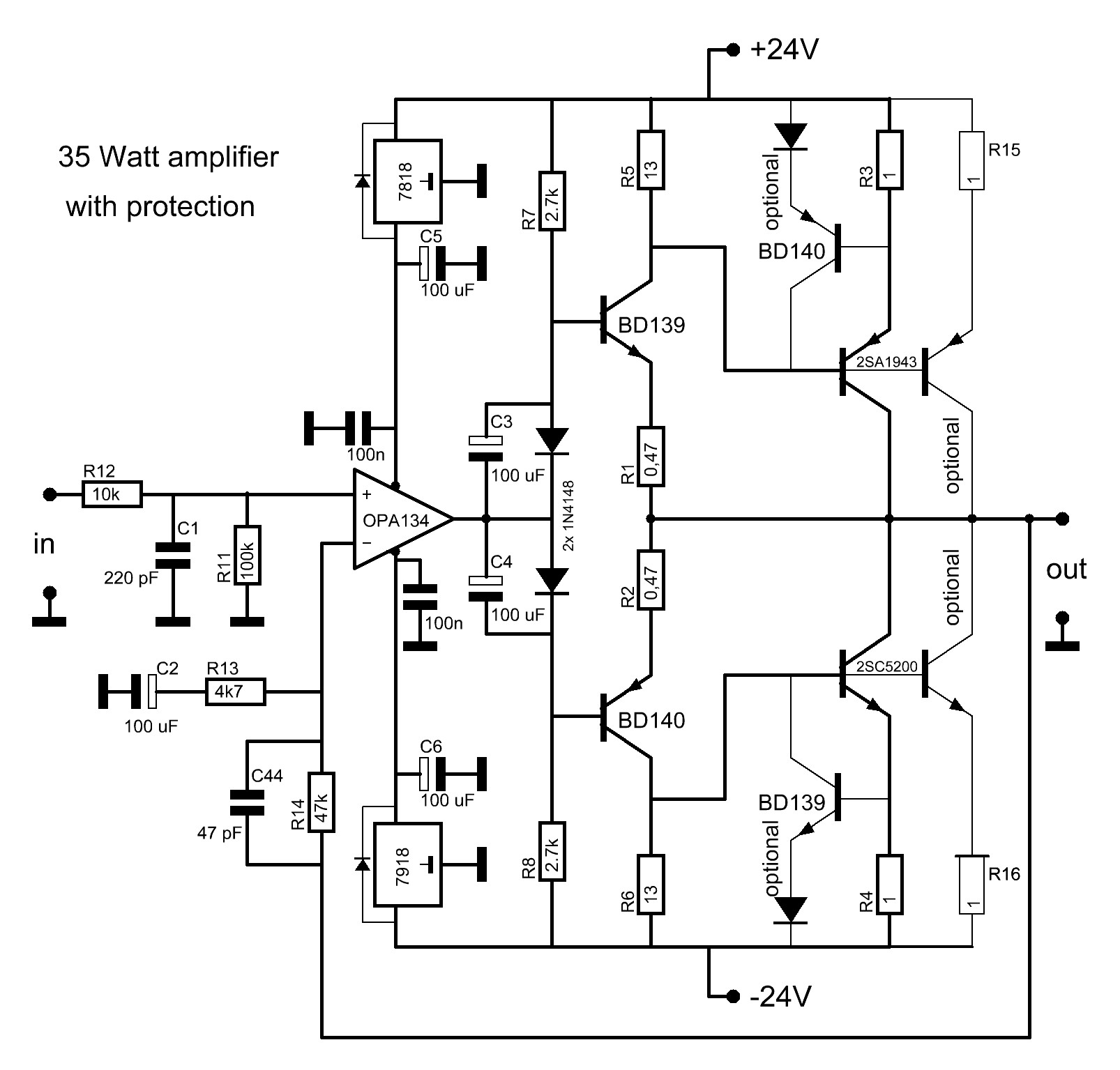

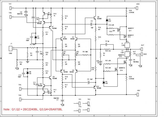

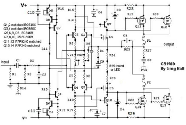

Most amplifiers would have hundreds to thousands of v/us slew rates before the final stage and then all that slew rate would be killed by slow final transistors in unity gain because of the BE junction capacitance which is actually the one who needs to be compensated in the first place through the feedback network or feed forward techniques or nested feedback to make all the preceding stages be in phase with the output.
Some few amps used high FT transistors in the final stage and they solved the problems much easier.
QSC regulates the slew rate in the output stage and makes the compensation much easier. Its very clear that at that power level that they sell you can't get any simpler circuit than QSC and they are known for being the most reliable amps in the industry too...
