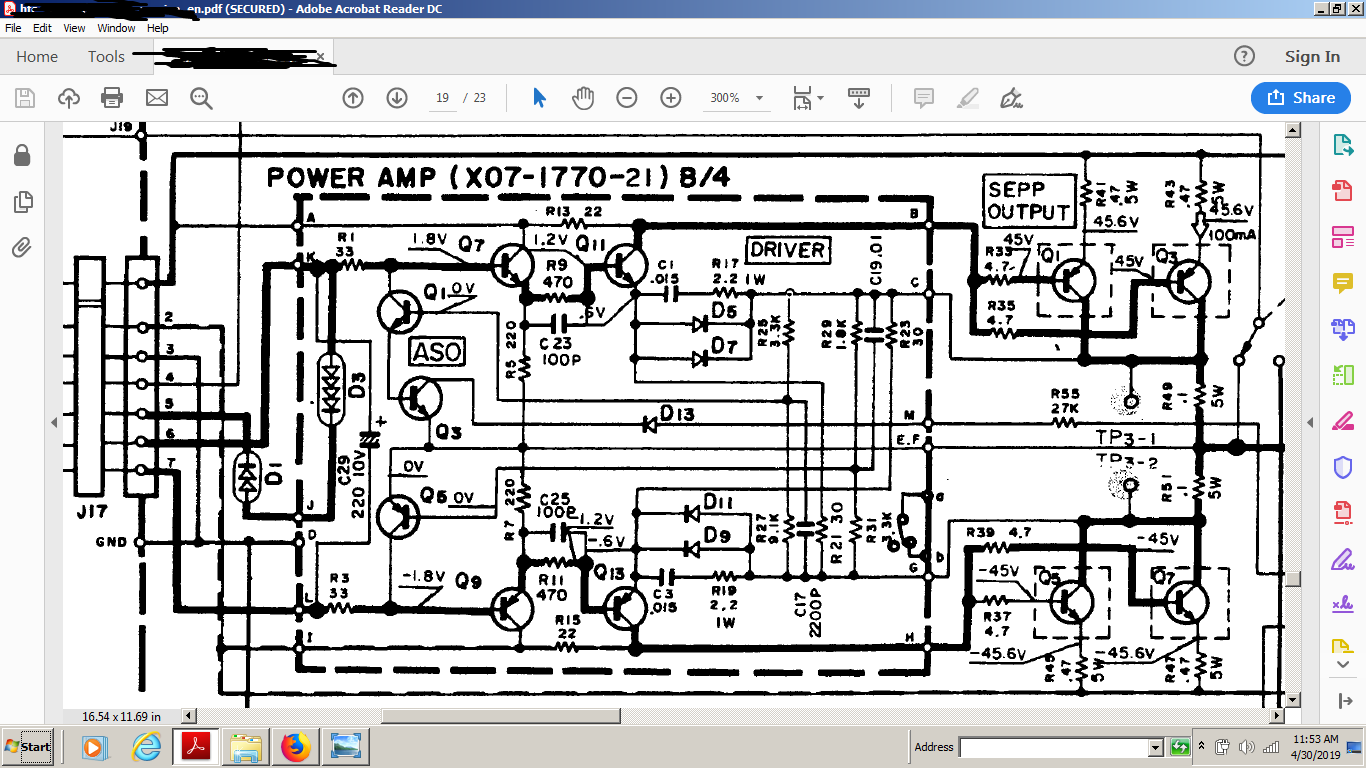

There were two different HDAM circuits.One was diamond buffered, the other was the picture you saw.I think you had the diamond version.The HDAM in Marantz was nothing more than a name for the metal can they put over their small signal circuitry.
I had a PM6800(?) and now have a PM7200 that does workshop duty blah blah. Both tout HDAM. When the PM6800 blew (years ago now) I lifted the can off in the power amp section to see what was underneath - it was just the front end to a very run of the mill VFA amplifier.
HDAM - marketing but I will refrain from taking that statement to its obviously logical conclusion!
I seem to recall this was just a vanilla VFA front end - LTP, Isource, single transistor+diode mirror driving IIRC straight into the VAS. I was quite surprised because they had made a big deal about HDAM at the time.
