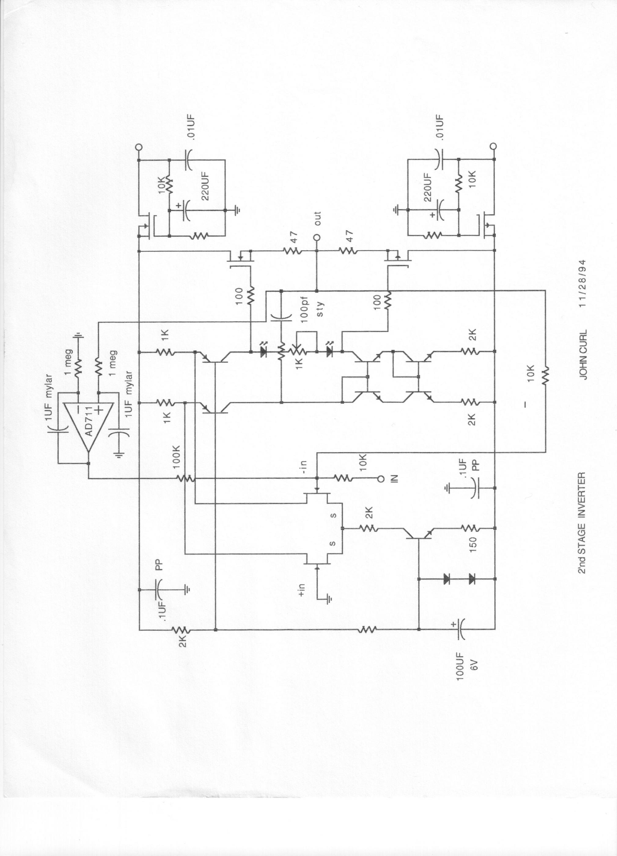

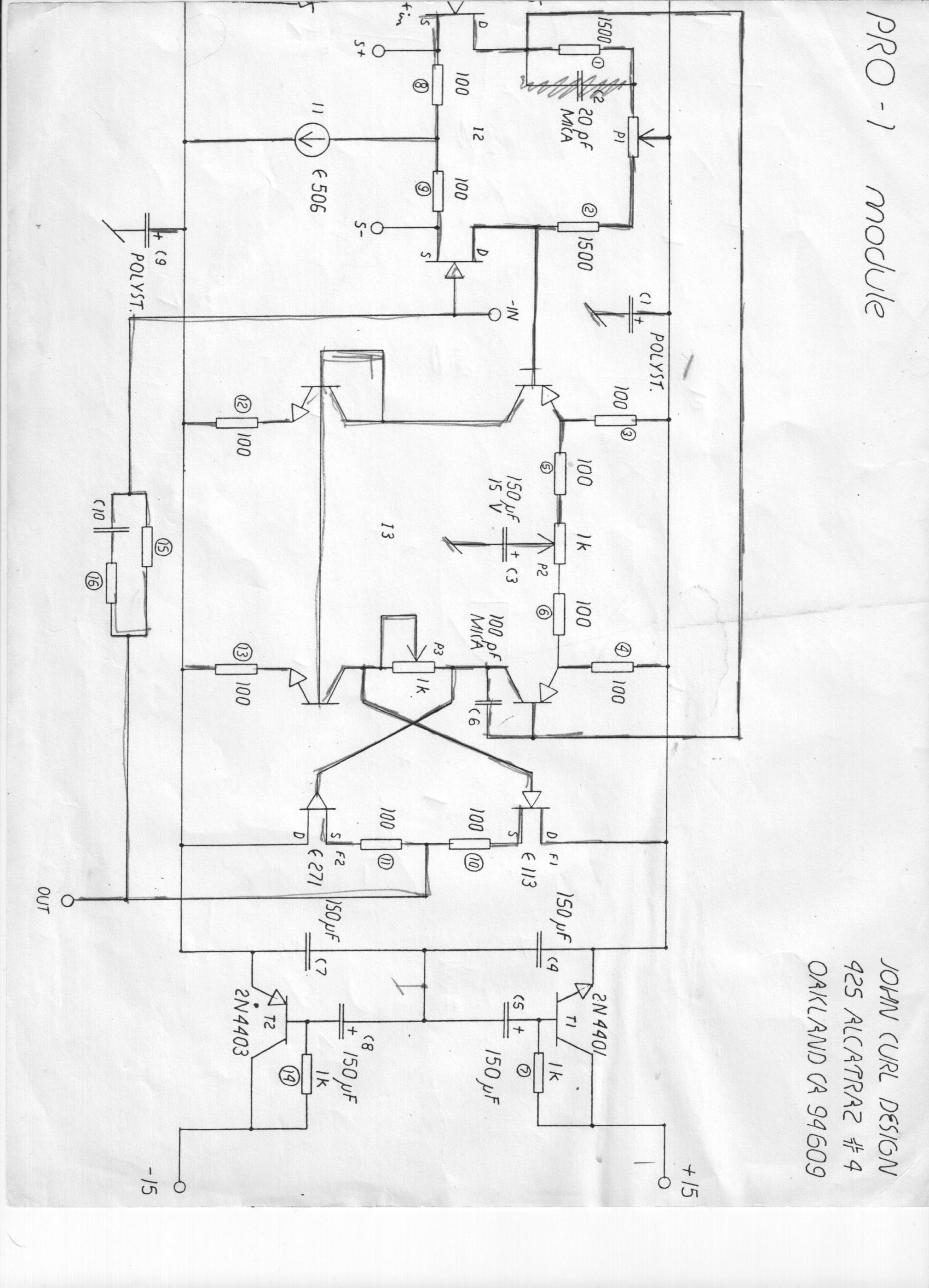

T, I use IC's, even the 5534 for my cheaper stuff, but I always seem to be able to make something better from discretes, especially with jfets. In 1978 or so, I carefully compared the 5534 with one of my studio quality discrete op amps and heard the difference. I even wrote up the comparison in TAA, back 40 years ago. I WANT IC's to work perfectly, that is the problem. They don't, at least for audio.

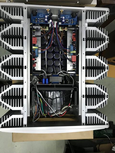

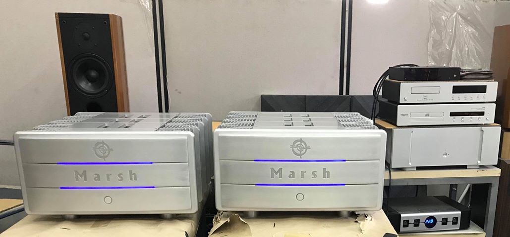

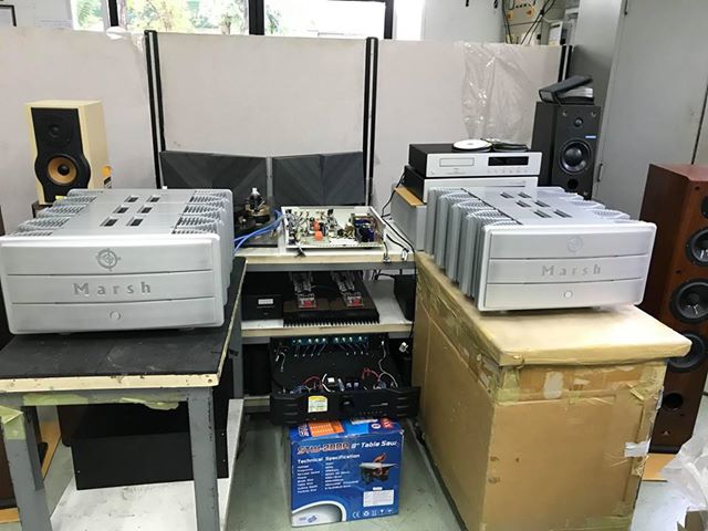

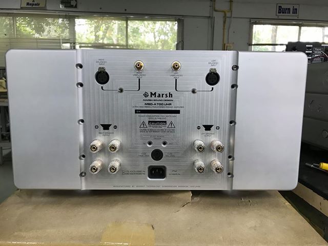

Monster Products back in the glory days before the economy was crashed..... distributed 2-3 channel power amps. I over-saw the design. So they are all CMA. Build by the same mob (yr 2003) who is making mine from Damir's design. A good deal if found on e-Bay. .003% THD +N at 400W/4
These below are THD and THD plus Noise data of Damir's. 2017 test. Single ended input.

Hi Richard,
I can see now clearly that your amps are CFA and used balanced to unbalanced converter and not mine small H-bridge board as I use.
Could you tell what balanced to unbalanced board thy used here?
Best wishes,
Damir
Hi Damir --
It is not a single opamp converter IC. Uses 2 CFA IC amps only/channel -- Better specs. My design choice for its use.
Keeping amp in CFA mode always when using single-ended input. The only input I use for home apps.
