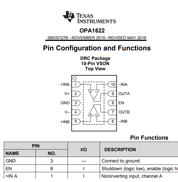

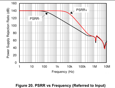

Ah but on PSRR is precisely where discrete can beat ICs. The reason being very simple - ICs have their Ccomp to the substrate typically and there's no 0V pin on an opamp. ... I've just remembered there is one fairly recent TI opamp which breaks with the 8pin tradition and does have a 0V connection. Can't recall its number though.
Here it is. SMD only, with thermal pad ---> not "socket compatible" with anything ---> invent your own idiosyncratic and incompatible pinout ---> no impact upon sales
_
Here it is.
Thanks. It might just turn out to be worth all the incompatibility to experience that galactic level of PSRR goodness on the +ve rail. Wonder if I can find one locally.....
Ah, good news, someone's done all the donkey work for a pittance, I just need to figure out what they did with the 0V pin....
OPA1622 DIP8 ????? ??????-???
_
I actually like that pin layout!
Impressive. That's nearly 30dB better than an LM4562 at 20kHz on both rails.
This is way op amp layout SHOULD be done. See fig. 60.
http://www.ti.com/lit/ds/symlink/opa1622.pdf
Nice one. Thank-you very much.Ah, good news, someone's done all the donkey work for a pittance, I just need to figure out what they did with the 0V pin....
