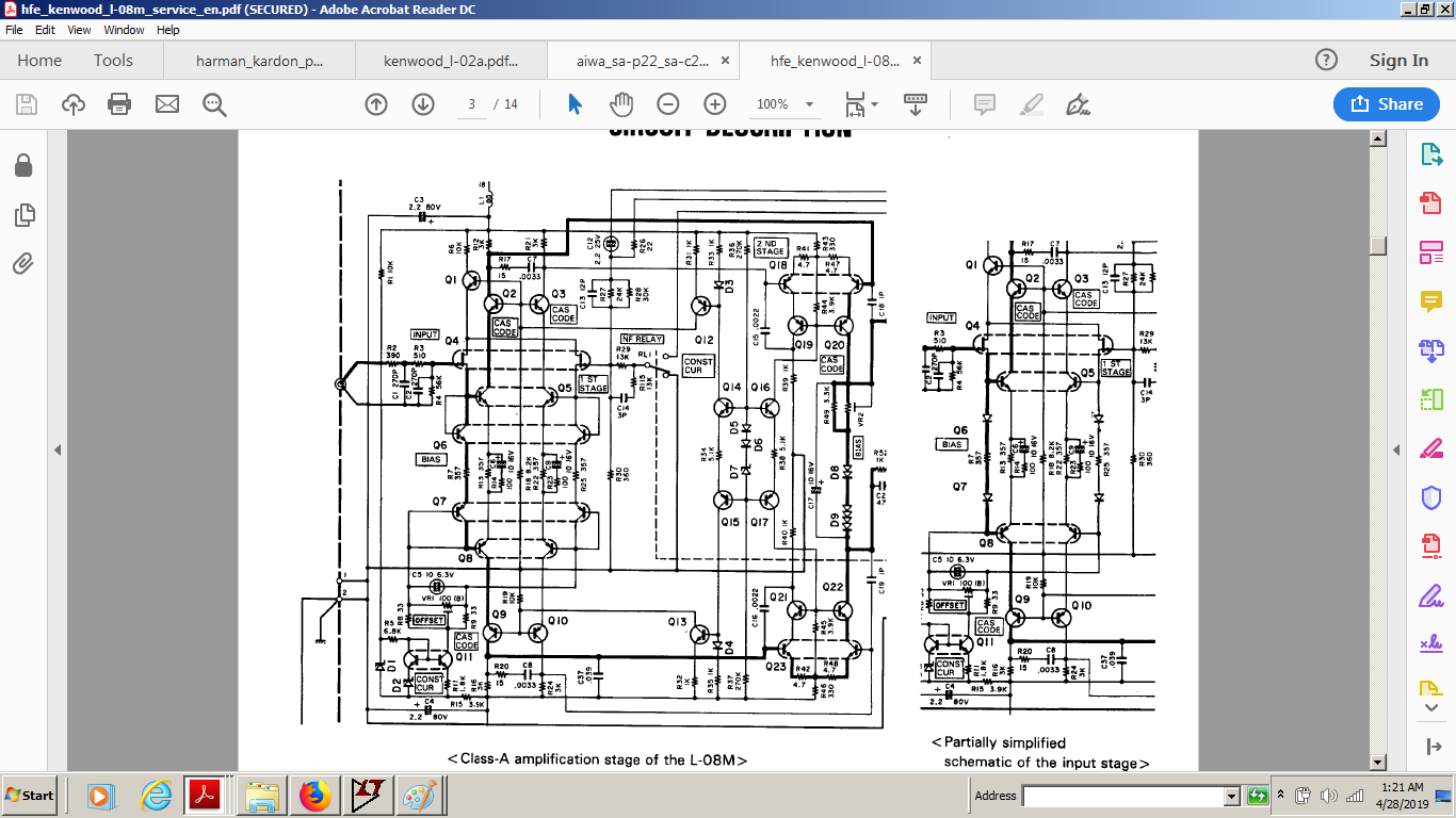

That phono preamp was made by the same guys who founded Accuphase , the Kensonic team who built all the Kenwood L-line including this amp and its preamp:
Accuphase switched completely , literally over the night , to current feedback amplifiers for the power section because of the "audiophile press " pressure which was heavily praising current feedback architecture's benefit in the 70's just as it does today discarding any possible good vfb design , but never abandoned the voltage feedback for the phono section although the phono section had the highest dynamic range to cover at a fixed gain for any input.
