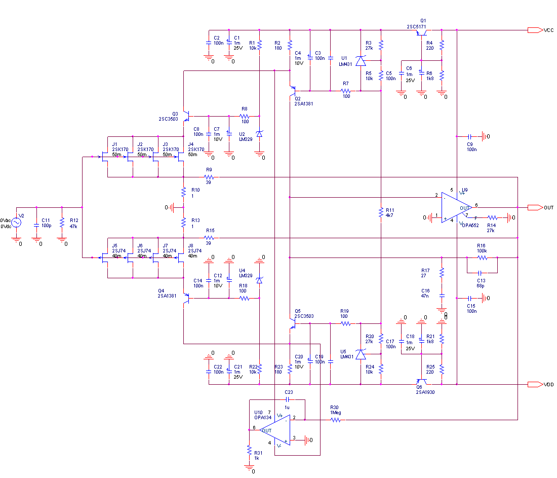

![HEADAMP.png](/community/proxy.php?image=http%3A%2F%2Fwww.synaesthesia.ca%2Fimages%2FHEADAMP.png&hash=7bce2ae55c0cdc530c0b49182b454f52)
For obvious reasons, this circuit is NOT an insult, and the same goes for all others here.
I can only hope you noticed the obvious fixes for all the original circuit topology shortcomings, with the exception of the poor PSRR, hence the power supply buffers.
For a version with a PSRR fix, see https://www.diyaudio.com/forums/analogue-source/333000-hps-6-1-a.html#post5675186
For obvious reasons, this circuit is NOT an insult, and the same goes for all others .
I dont see anything at all new here. Variation on what JC has been doing and showing. Albeit with a lot more lipstick on it.
Complimentary jfet... paralleled, cascoded. Big deal. Nothing new there. Folded cascode. Nothing new. Oh. an opamp. wow.
BTW -- when I cascoded and current sourced the 4 transistor circuit et al... it didnt sound better with the loudspeakers of the day. JC already told you to use as few parts as possible which gets the job done will sound best. Maybe you thought I was going to show my best work to you? hahaha. I dont think so. I did what JC does... showed the creation from some 40 Years ago. I was about 30 years old then. I am 74 now. Lots of great CFB IC and discrete now.
Show me something new. A circuit trick, maybe. A useful mod. Distortion numbers. A patent.

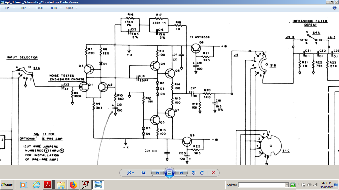

It's all about the higher authority of the feedback network over the input in fact and Holman applied this in his APT voltage feedback design.

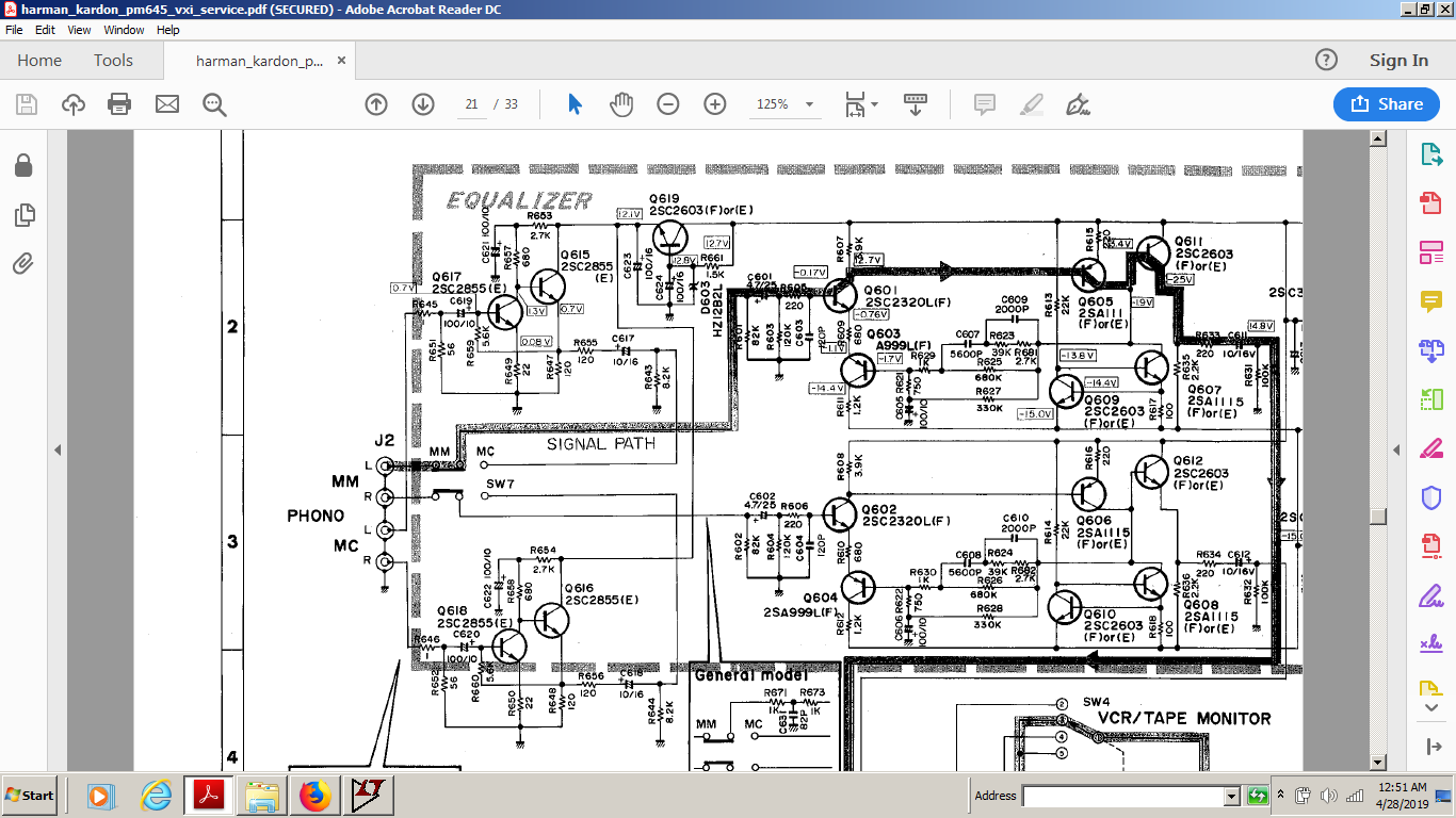

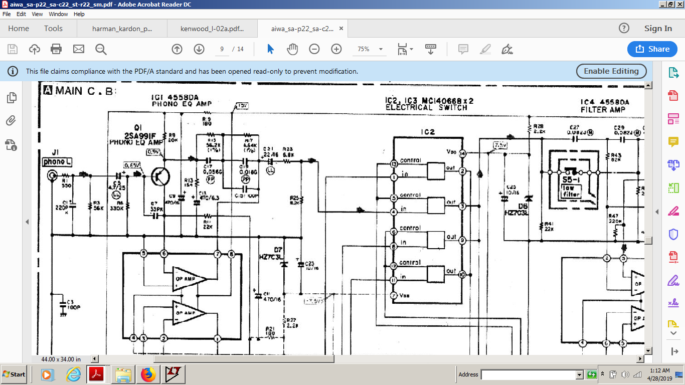

But then...if we're talking about lower count component designs i will show you two commercial designs that are very hard to beat: Harman Kardon 645 vxi and Aiwa c-22
both discussed here in detail : Modified aiwa riaa j-fet phono preamp. You'll see there how i made the HK design even lower count design by using an op-amp and a fet at the input .I used that design for a cassette player tapehead preamp and it worked very well actually, just not lower noise then a classical transimpedance Nakamichi design because of the collector resistor in the lower bjt transistor.That could have been absent just the distortion would have risen up a bit...

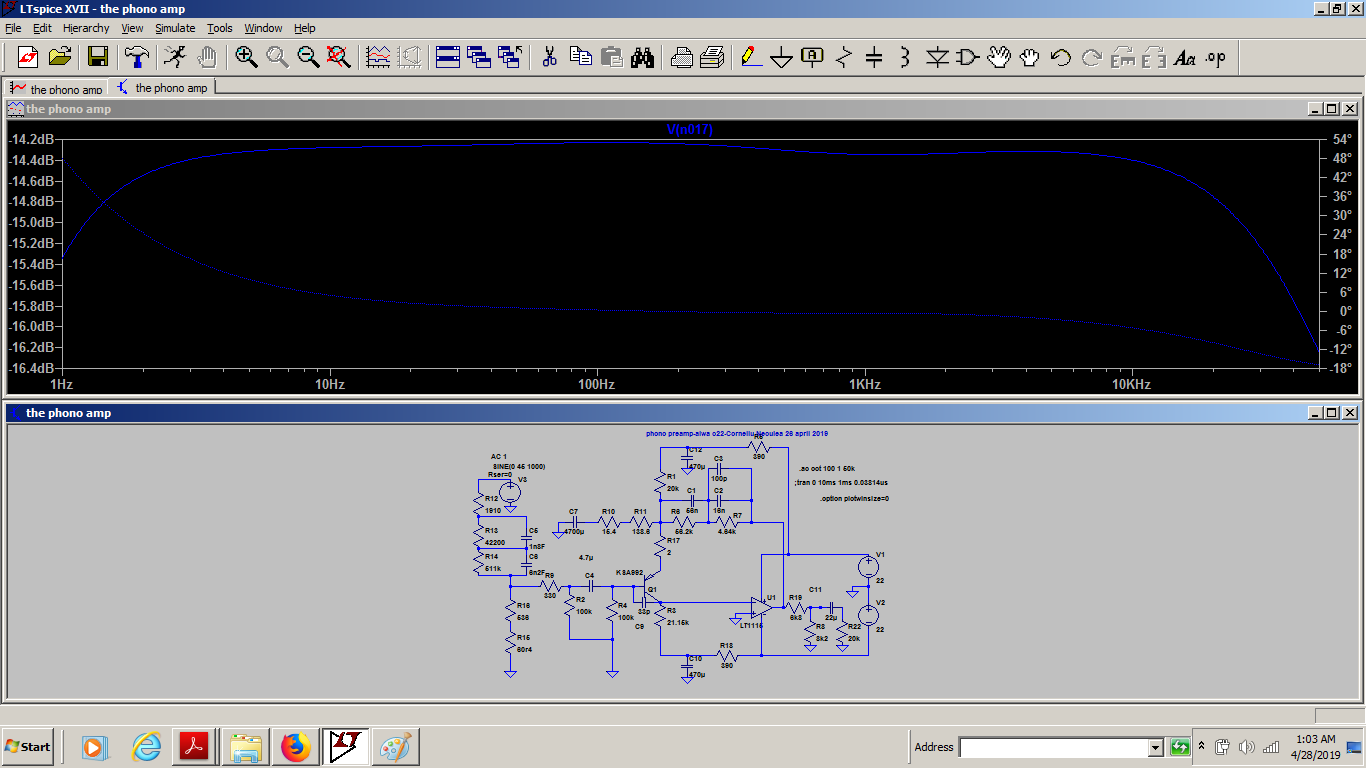

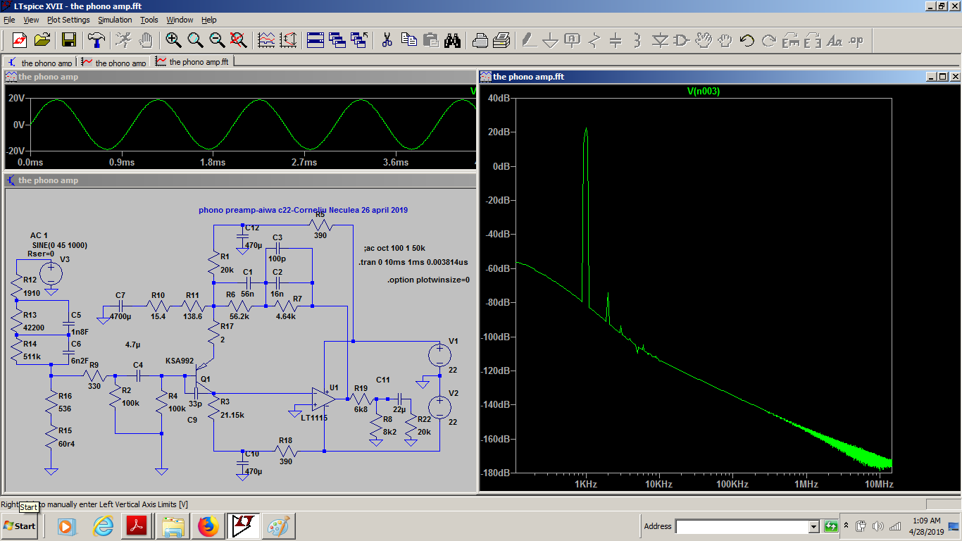

I uploaded also two sim for a modified version of aiwa c-22 only for the power supply as i already failed with a fet input in getting a better sound than the original design could get me with all the simulations and better components .I thought that the input capacitor or the use of a low noise fet would make any improvement in the design, but it was not the case, just tougher useless job.There's no audible distortion due to the capacitor at the input for an mm cart.
