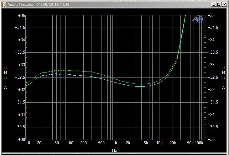

Levinson JC-2
My problem with the Levinson JC-2 is not really the line stage. It would up being in the Phono stage (active EQ)
Phono stage alone, gain 32dB, deviation from RIAA, 75us is in feedback network, thus increase in output level above 20kHz

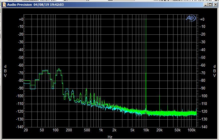

FFT 1kHz, 25mVrms input, 1Vrms output, 2nd -102dB, 3rd -114dB
FFT 10kHz, 125mVrms input, 1Vrms output, 2nd -100dB, 3rd -110dB, not bad
