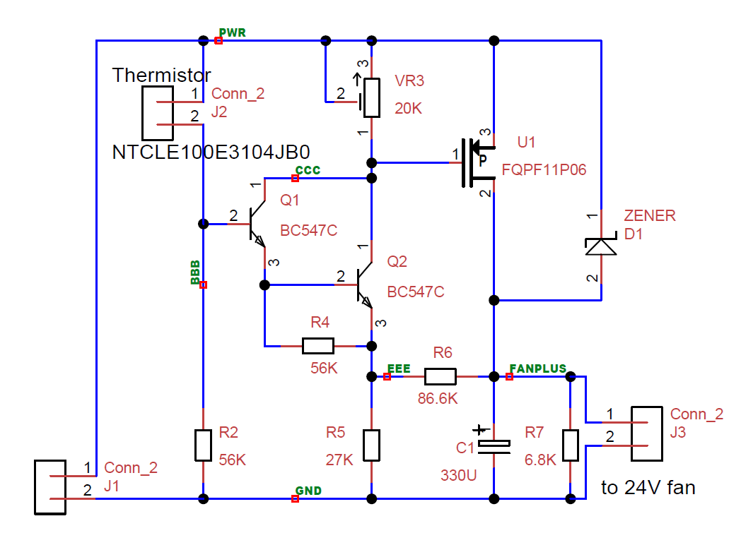

It appears to be a puzzle to be solved by the reader.Ah Mark,
Looking at the schematic, where do you put the fan?
Also I call the card "Perf Board."
By a short analysis (and no, I didn't cheat by using LTSpice), I've determined that the fan goes between ground and the line labeled "FANPLUS," or across resistor R7.
And of course the solution to "getting rid of the heat" brings up the problem of "getting rid of the fan noise." My first thought is a PC isolation box, but that's surely not as pretty as the device being cooled. The second thought is a "fake" amplifier that's the same (or looks the same) as the real one, but only the volume and power controls are wired up, connecting to the "real" amplifier in a closet somewhere.

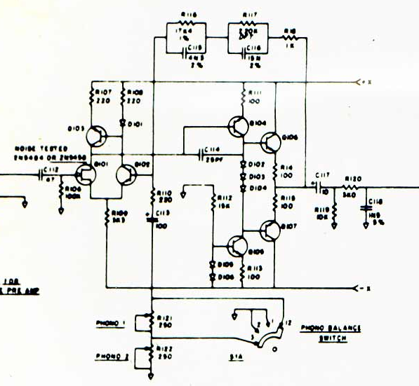

Hi Dimitri, thanks again for the measurements of the Levinson JC-2.
It is interesting that you showed the deviation in the RIAA from ideal.
I would like to explain the history of this:
Back in 1973, when the JC-2 was designed, I had a Heathkit IM analyzer and a Heathkit sine-sq generator as my reference test equipment. I did pretty well on those two, like speaker measurements, lowering the self noise of our B&K mikes by 10dB, achieving 0.4nV/rt Hz with my patented JC-1 design, etc, BUT it was not optimum for an ACCURATE RIAA. The deviation from 0dB on the Heathkit meter alone was probably 0.5dB or more over a 10dB range with level. It was just a vacuum tube based circuit and no more was expected of it.
Also, there were no PRECISE measurements easily available of what the absolute dB correction should be, just time constants of 75us, etc. No, Walt Jung, nor Dr. Lipshitz had published their RIAA passive pre-correction circuit then and would not for another 7 years. So, I used what esteemed engineer Richard Burwen did for the RIAA correction of Mark's existing LNP-2 phono stage. I just copied his caps and resistors. After, Burwen must have known what he was doing. '-) Well, he didn't, and when I confronted him about it a few years later, he said that he liked the sound of that EQ and that was good enough for him. Today, of course, with precision passive pre-correction circuits and better test equipment, we can do +/- 0.1dB over the whole frequency range with precision caps and resistors. But back then, almost nobody did it perfectly, unless by accident. The first guy to do it right was Tom Holman, I believe.
Yes that is right. I was teasing Mark as he left off the terminals. He mentioned the smoothing capacitor but was not quite explicit in the fan connection or Zener diode power dissipation. With a slight modification the circuit would not be rail voltage dependent.
Looking at the schematic, where do you put the fan? ... ... Also I call the card "Perf Board."
Hi Ed, as member benb has remarked, the fan is the load which the Pchannel MOSFET drives. It connects between the drain of the MOSFET driver, and the opposite supply. As benb said.
The schematic I attached, was from LTSPICE. I think it creates prettier schematics than the alternative. But LTSPICE does not have "connectors" as primitive elements. The schematic I actually used to make the board, because it inter-operates with VeeCad, was from TinyCAD. The TinyCAD schematic is attached below. It is not as pretty. But it DOES show the connector for the fan, and the two other connectors as well. (These are visible as green blobs of plastic in the photograph). Member benb was right.
Stripboard (wikipedia entry) has a grid of holes with parallel stripes of copper which span the length of the board; each stripe is one row wide. It is the stripes of copper which make it useful, in my opinion. Perf Board, in my experience, does not have board-spanning long stripes of copper. It has either no copper at all, or else it merely has freestanding individual donuts around each hole, where no two holes are spanned by copper.
BTW the Zener part number explicitly given in the post, is 1N5929B which is 15V & 3W ... more than good enough for any of the little whizzers I bought off Mouser. In fact it's more than good enough for ANY of the 24V fans sold at Mouser for less than $20. (All the sub $20 fans are less than 4 watts i.e. 167 mA). Want more? Redesign!

Mark,
I didn't see the copper busses. Vero board is different that way. Never heard the wiki name. Do you have a Vero board trace cutter or just use a knife.
I do take things like showing the fan connection seriously, particularly if you look at many of the posts here. Also have a dislike of circuits with a strong dependence on all parameters. A 24 volt unregulated rail is subject to AC power line whimsy. It can range from the equivalent of 110 volts or even less to an actual 135 volts RMS. (110 equivalent from flattened voltage peaks due to diode supplies loading.)
I need to look around to find the way I did it when I had the fan control issue. I recall using one of the solid state temperature sensors. (LM35 family.)
What you may not know is that a bunch of amps in the Store use (regulated) 24V SMPS with filtering, and lots more use (unregulated) 24V linear supplies feeding constant current loads (Class A amplifiers) and thus the supply voltage itself varies not much at all.
Nevertheless, good luck eliminating supply dependence. Node "BBB" in the 3 transistor circuit is a temperature dependent percentage of the power supply (it's a voltage divider after all). To eliminate supply dependence you would need to down-regulate to a constant voltage and then arrange your voltage divider (or Wheatstone bridge) to output a temperature dependent percentage of that constant. Don't forget, at the end, you must apply that percentage to the fan itself, i.e., (supply independent X%) times (unregulated VCC volts). Without an analog multiplier of course.
It is possible (everything is possible!) and it has been done, but the implementations I've seen all work in percent-of-supply terms from input to output, i.e., they assume that supply variations are much much slower than the bandwidth of the fan control system's feedback loop.
You might want to use the MAXIM chip inside a little mu metal box, feeding an analog control voltage output to an analog output buffer-driver that's outside the box. Build a one stage or two stage voltage regulator (3.3V!) inside the box and assure yourself that the fan voltage is a well regulated, well controlled, X volts independent of supply. Uh, that is, when the fan voltage is low. When the fan voltage X volts is high, and the varying supply means that supply < X occasionally, well, you are screwed. Maybe a cautious person runs a 12V fan from a "24V" unregulated supply, with an emitter follower fan driver. Now you can tolerate more than 33% variation on your unregulated supply with no impact upon the fan control system. And of course, double the total power dissipation.
edit- Stripboard trace cutter is, conventionally, a 5/32" drill bit twisted with fingers only, at a slow speed. The drill chews away all of the copper and only a small amount of the phenolic circuit board material. Clean-up with a continuity buzz tester, a headband magnifier, and an X-acto knife.
