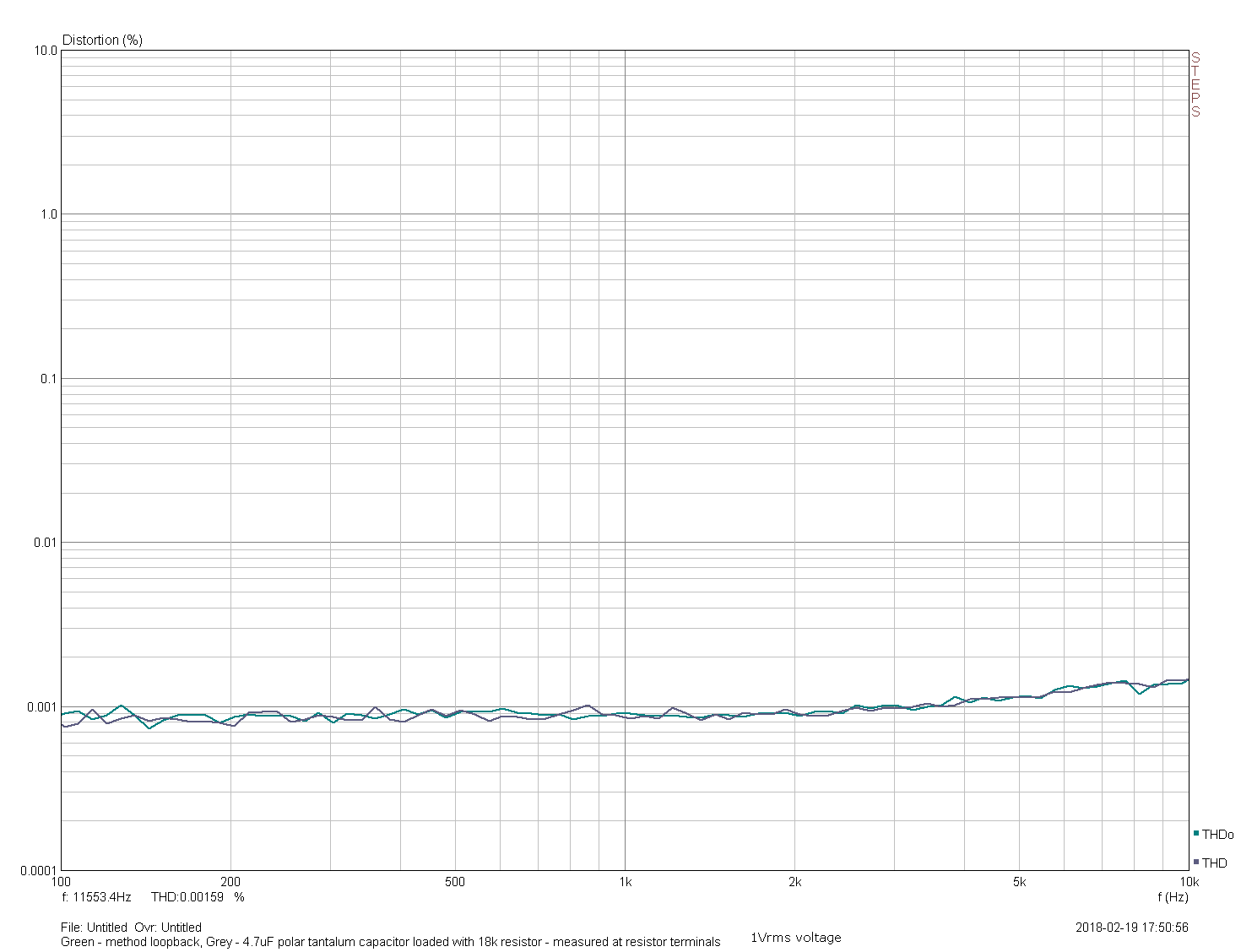

Speaking about coupling capacitors "distortion", I have the series of 6 Cyril Bateman's articles published in Electronics world since July 2002. IMO it must be emphasized that he was not testing the capacitors as coupling caps (= almost zero voltage across the cap), but he was forcing voltage on the capacitor terminals via small resistors. That means, he was measuring distortion of voltage across the capacitor, which may make sense only in case if they are used in crossover filters, but makes no sense in case of coupling capacitors when the F(-3dB) high pass filter point must lie well below 20Hz, thus there is no voltage across the capacitor in the audio band. I also made my own tests and never found distortion behind the coupling capacitor in a properly calculated CR coupling circuit. Only if the capacitor started to be loaded and acted as filter, then especially high Q ceramics like X7R started to distort, which is expectable for the dielectric well known as nonlinear.
As an example, I have just now measured a 4.7uF/6.3V polar tantalum capacitor, age about 30 years (should be very bad, right??) connected as a coupling capacitor loaded with 18 kohm resistor. The output voltage is measured on the terminals of the loading resistor. Thd vs frequency plot is shown, with loopback in green color and with inserted CR in grey color. Though the distortion method is not very sensitive, about 0.001% (-100dB), it can be seen that the measurement with CT inserted perfectly follows the loopback curve. Input level is 1Vrms. So, with 1Vrms input and -100dB distortion resolution and 18k load, even the polar tantalum 4.7uF capacitor does not insert additional distortion. In other words, there is no AUDIBLE distortion added. The tantalum is not DC biased and is NOT the bipolar type. It just has no voltage across its terminals.

DA, leakage, aging, temperature issues, this is all for sure true (and no need to be lectured). The issue here is using proper and correct technical terms. When you say distortion, it normally stands for nonlinear distortion. And it is very difficult, better say almost impossible, to find nonlinear distortion in a capacitor coupled circuit if there is no voltage across the capacitor. No voltage means no DC and no AC.

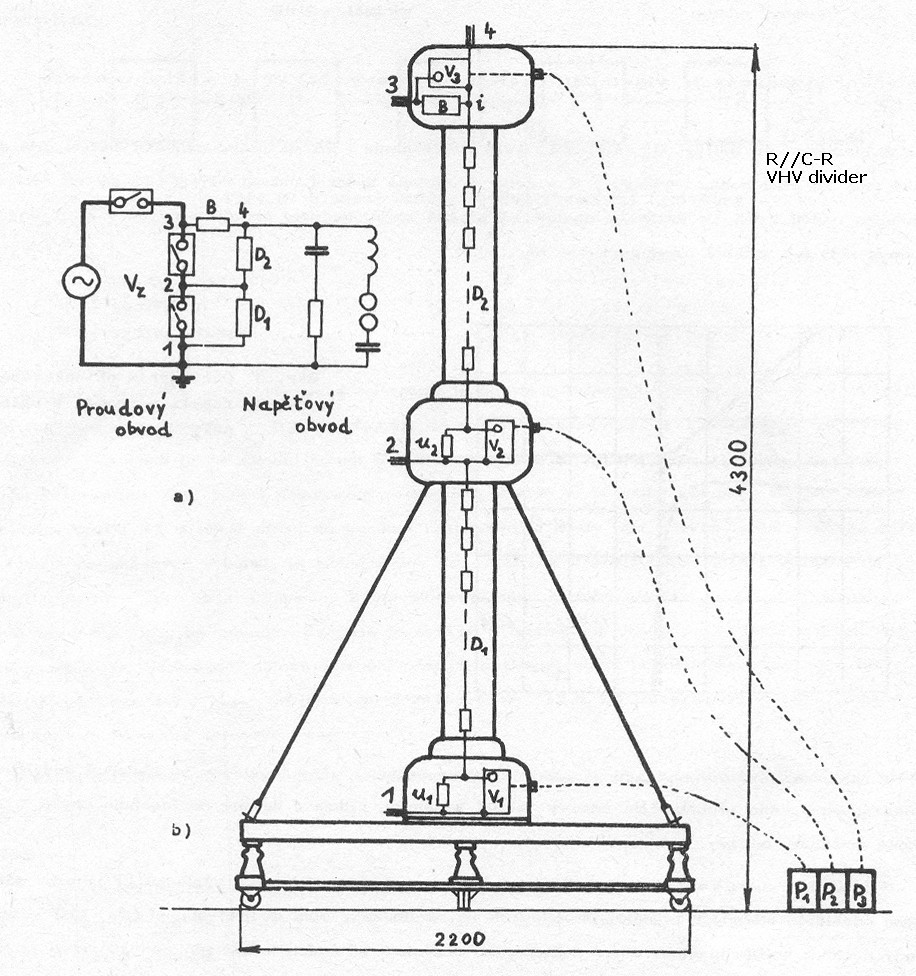

Regarding DA in capacitors - I am probably more aware of various capacitor issues than some of you might have expected. In the eighties, I was working on VHV dividers for high voltage tests of SF6 circuit breakers and similar instruments. Like the one in the picture, this beast had step response rise time about 100 ns. DA in capacitors was the big issue, which was suppressed (discharged) by R//C-R cell chain structure. Yes different issues, except for nonlinear distortion. That would be the last one on the list 😀.

I found an interesting paper in which the authors outrageously claim DA of PCBs can pose a problem:
http://www.analog.com/static/import...018494695982855668424783486554001060AN348.pdf
(sorry Scott, the water wasn't muddy enough...ducks and runs...)
Obviously theirs a very different application with a different hierarchy of critical factors.
