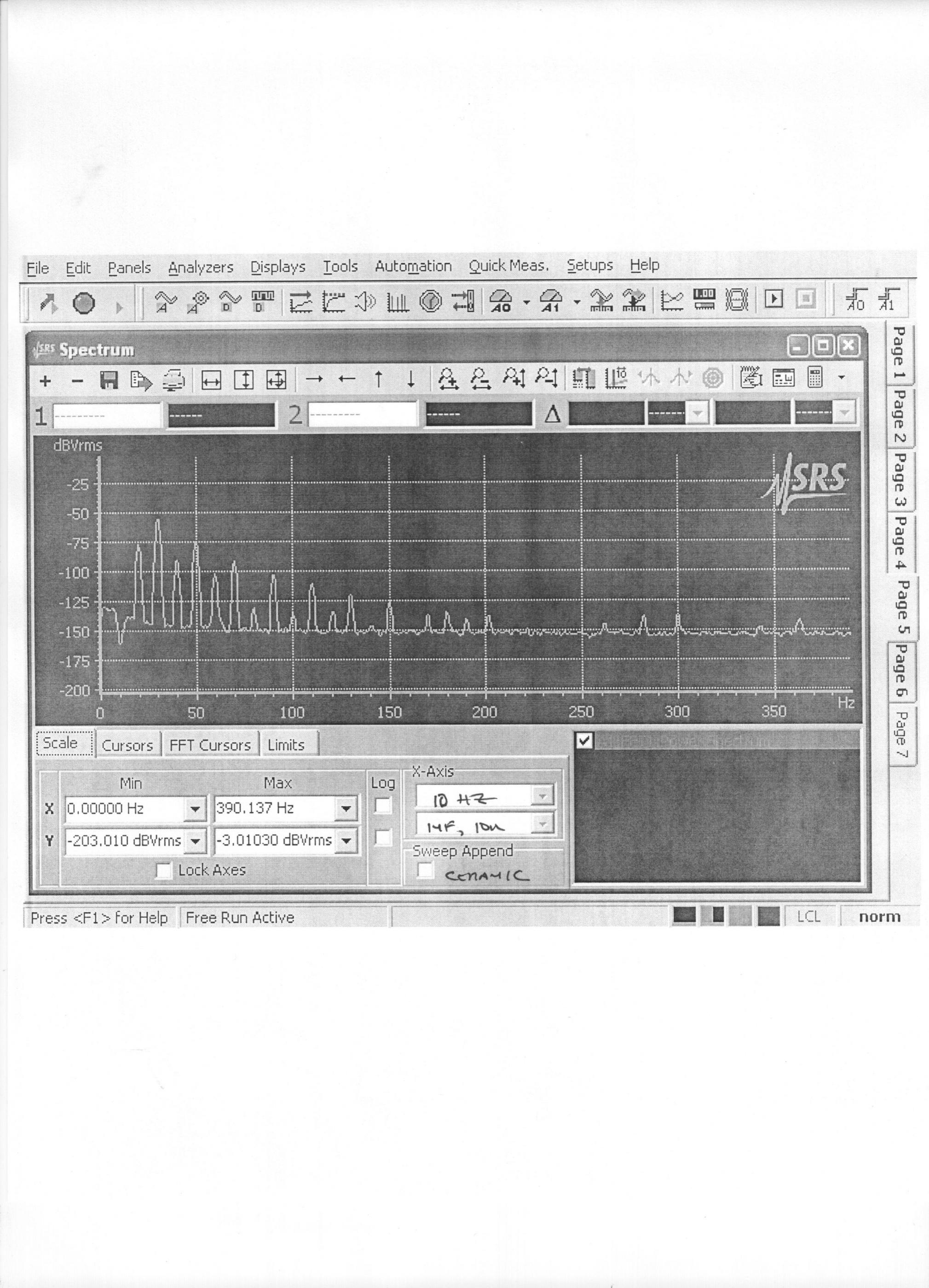

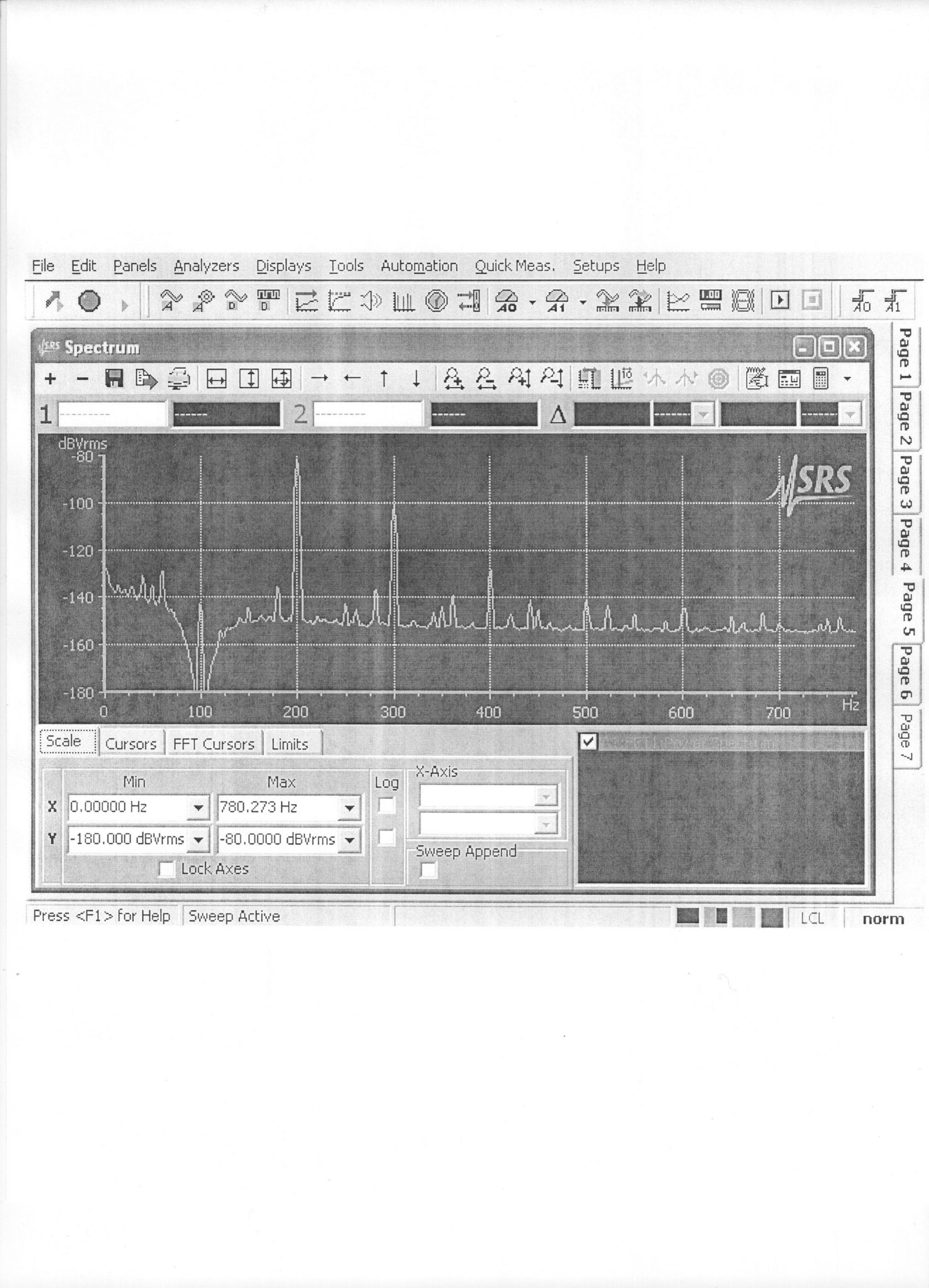

PMA, I take exception to your criticism of my 'design experience'. It just so happens that in about 1977, when I designed the Symmetry 'transient perfect' Crossover, I used some 1uF Mylar caps that were compact, and measured virtually perfectly, as output coupling caps. I already knew about the problems with Tantalum and ceramic coupling caps, and since these Mylar caps were small, linear, cost effective, etc. they were a staple in my design inventory. However, in 1978 or so, I was told by Symmetry that they had shorted out the cap, (this was easily done without much of an offset problem) and they found that the crossover sounded better. I really did not want to believe it, as I had no reason to fault the cap (at the time), but unlike you PMA, I listened to what my critics said. About then, Richard Marsh and Walt Jung did their looking into caps, and people in my vicinity (Berkeley) were making cap comparisons, so I got introduced to PP and polystyrene caps and I actually tried them out, rather than play the engineer who knows everything. The PP and PS caps worked BUT they were so large! So, in later designs I decided to servo, as reasonable cost jfet input IC's were being brought out that were laser trimmed for good offset. I could stick my Mylar cap there, and it would hardly effect the sound quality, no matter what the problem was, as the servo can be almost completely removed from the main path and its potential 'non-linear' effects greatly reduced by output scaling and I have continued doing this for the last 35 years or so. Why do you want to go back to the old ways of doing things? What are you trying to 'sell' us?

....In case that speaking about the "feedback cap" you mean the capacitor in the bottom branch to ground, then the value is much higher than the 4.7uF that I tested. It would be rather something like 220uF to keep the low frequency corner in Hz (like 220uF + 470R). Then again, there is almost no AC voltage accross the cap so no distortion. And this 220uF cap may be easily shunted with a 100nF polypropylene.
The shunt electro makes large audible difference in this location.
Shunting with low value solid/film cap is mandatory ime, yielding cleaner/clearer sound and counter intuitively subjectively extending both highs and lows.

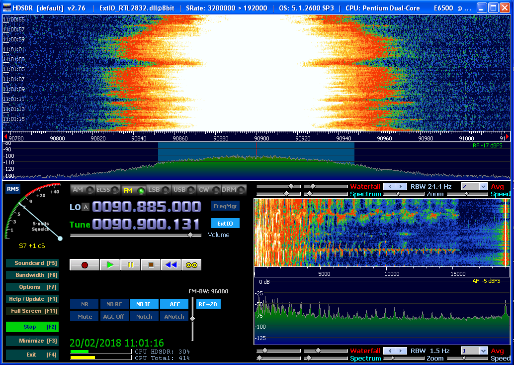

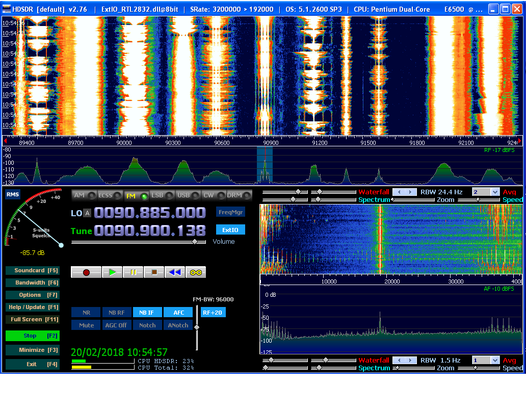

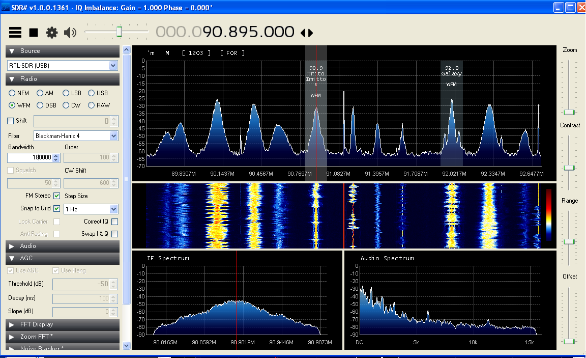

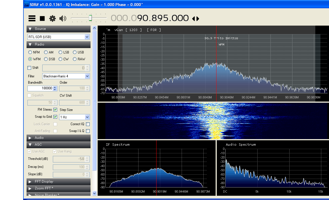

Radio reception is a very interesting topic technically and context wise and I may be one of the last to deny the technical beauty of analog receivers both tubes and transistors.
Now, the RF spectrum survey, radio station reception conditions, antenna/feed line performance, the all important IF bandwidth requirement and much more can be monitored with the use of a Software Defined Radio (SDR) unit (*) and some freeware software
It is not easy to think of what the flexibility and versatility of such software can provide in terms of reception optimisation and visualisation of various sections of an existing receiver’s unit.
You see, as a consequence of it’s adjustment’s flexibility, an SDR unit can also be used as a multifunction tuner monitor instrument by feeding it’s input with a signal from various RF and IF points from an analog tuner that we want to service, adjust, fine tune.
It’s value as a multiple band-multi mode communication receiver is to be experienced.
George
(*)The SDR units start from around 20 US$. 500 US$ is where you should stop.
Mine is at the bottom of the evolution/price list (RTL-SDR with RTL2832U chip)

George: SDR can do some amazing things. I watched cellular technology evolve from std 2 step downconversion of original GSM (80s tech) to Zero IF with some pretty impressive ADC on the front end to just slurp up a chunk of spectrum and let DSP deal with it. On the transmit side even more fun. New modulation scheme? just do a software update. Horribly inefficient for the PA but shiny's need their bandwidth.
