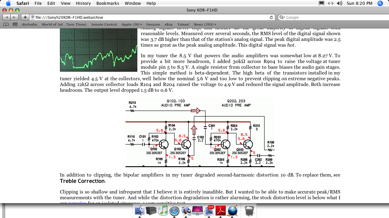

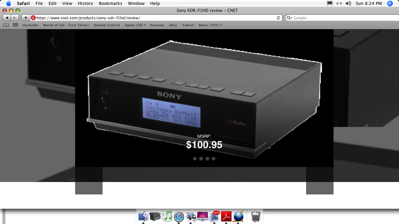

Chris, I replaced some caps in this Sony tuner that appear to be ceramic. What do you think. C101, C102,C202

Hi John,
How about C201? That looks like a nasty one.
Not having seen one of these on my bench, I can't say much about the original capacitors, but what you have done is what I would do if forced to try and upgrade one of these. At $100, trying to improve it is silly unless it belongs to you. Also, the gain stages shown are not very good for thermal stability. I wouldn't be too surprised to see huge variations in operating point. It has other problems that make it a poor candidate for improvement.

I chose this Sony tuner, because Richard Sequerra told me it was the best design out there today.
which model is it? HD Radio? Really small. I have that one also. Super RF specs. I can only use the Kenwood and Sony HD because the others cant bring in distant stations.
