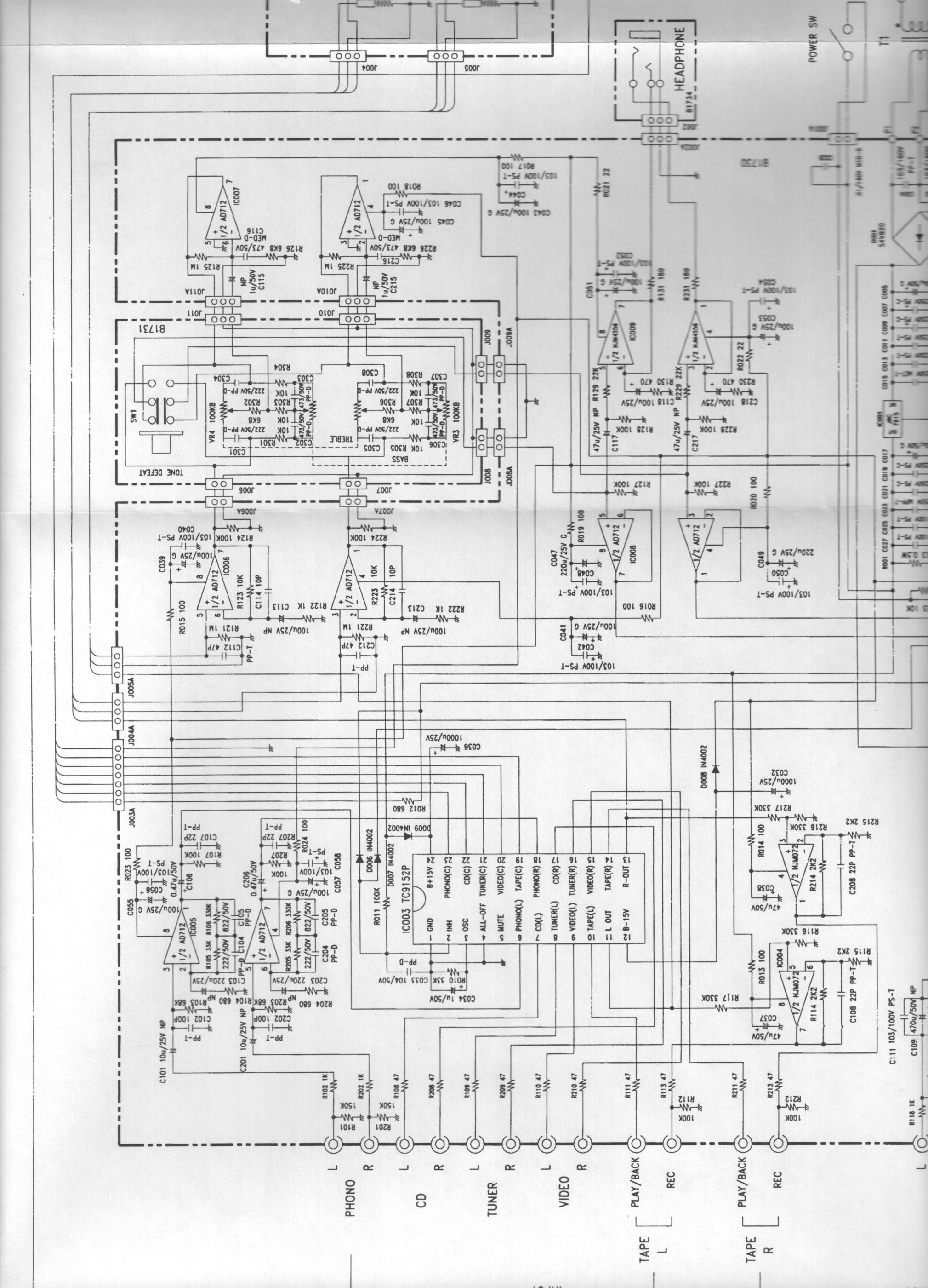

Yet, many of you just don't see where the electrolytic caps are necessary, without a servo, and that is mainly in the FEEDBACK LOOP to ground, in order to remove the forward gain of the stage at DC. Here is where 'the rubber hits the road', not on an input cap addition. This is where the load resistance is the LOWEST in order to preserve low noise performance, and an electrolytic cap is almost MANDATORY without a servo. Nowhere else. Look again at the commercial preamp schematic that I put up, note at the electrolytic caps used in the feedback loops and note what they have as a load. This is the primary place that caps can really show their lack of ideal behavior.

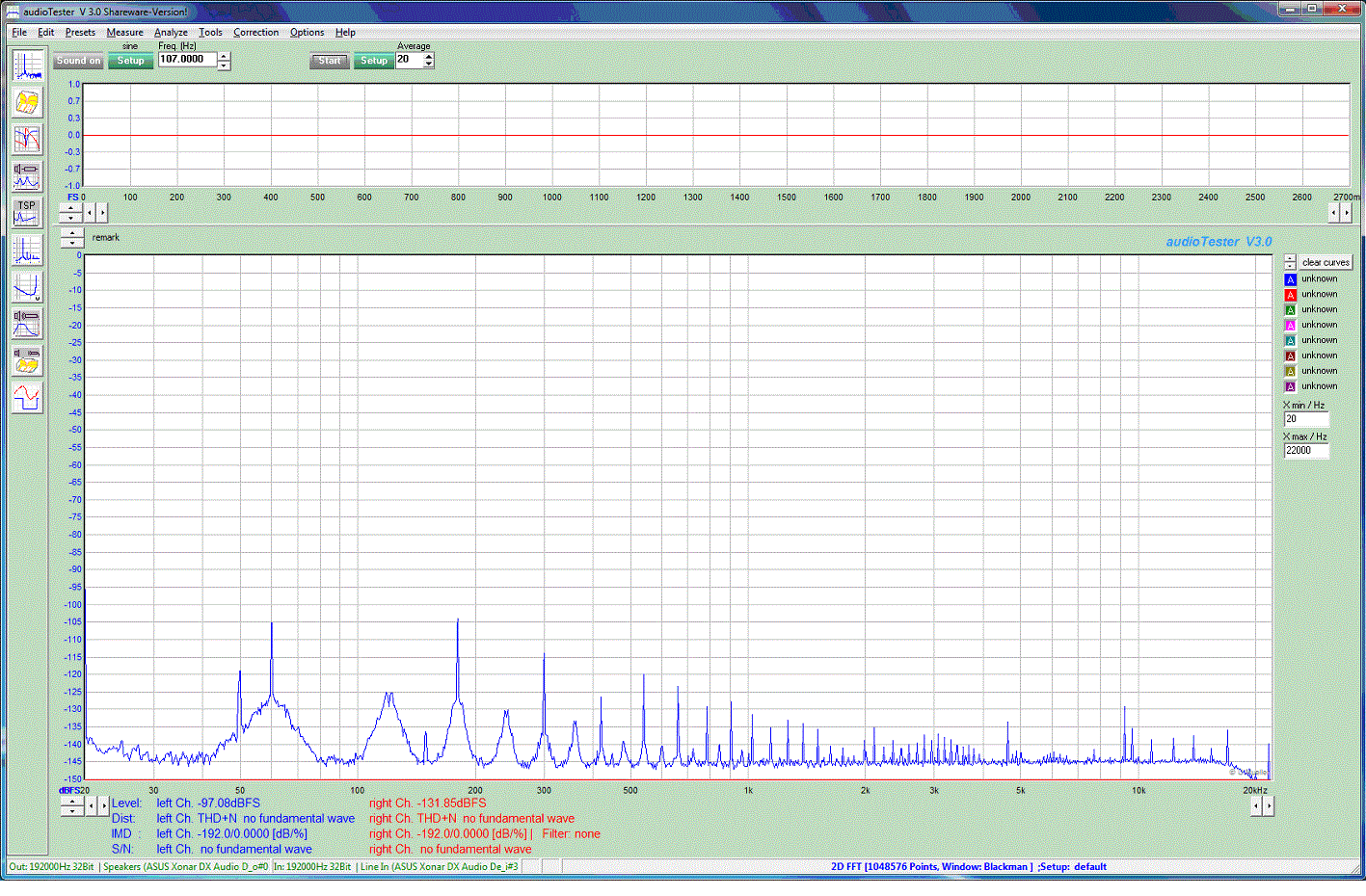

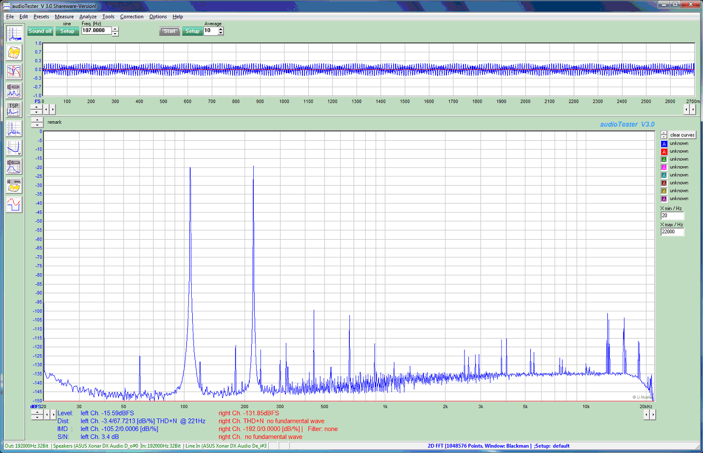

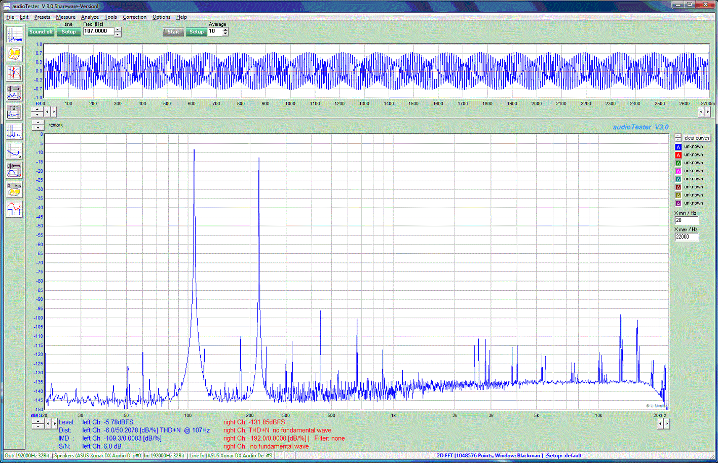

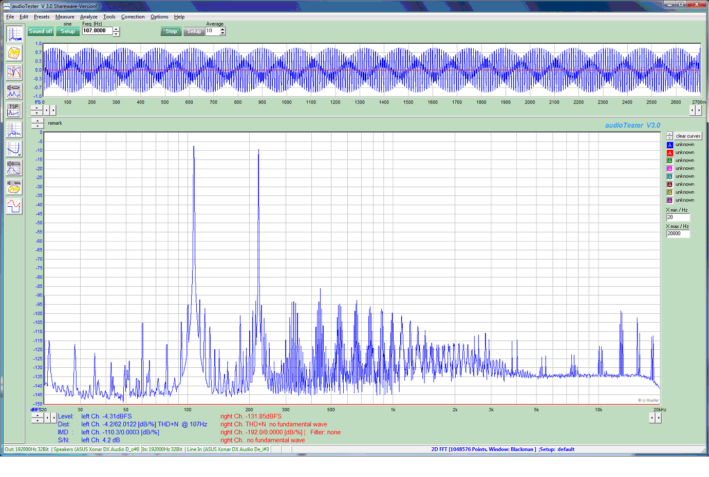

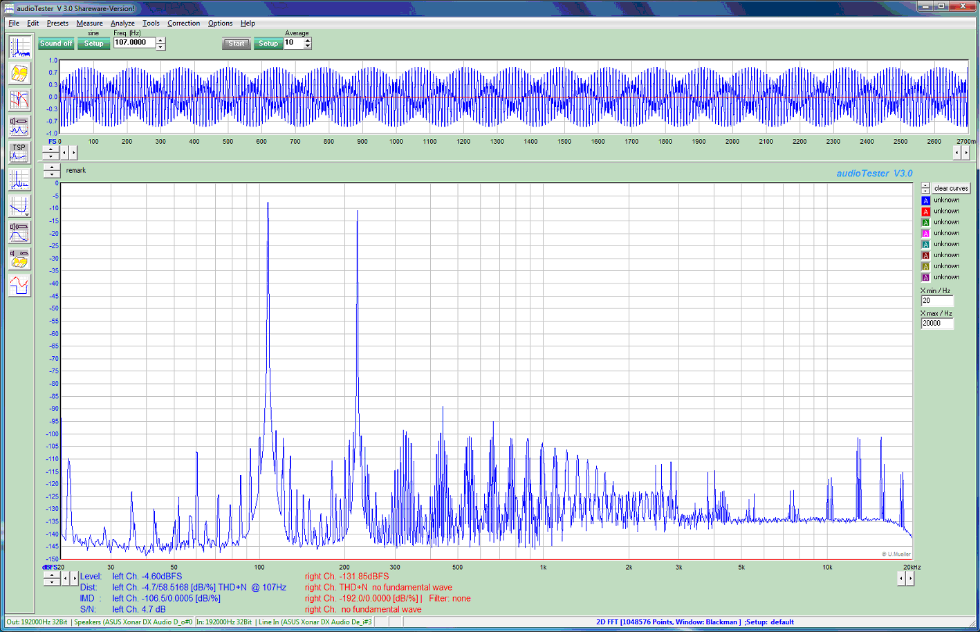

Maybe I'm doing this wrong, but the only caps I can see that distort badly are Al electrolytic and PP in oil Motor Run caps.
I summed two signals with 600R limit resistors and fed the resulting signals through various caps, into my computer sound card to look at the results.
The first image is without the sound card 107Hz signal and IG-18 209Hz signal turned on.
The second image is with the both signals on, but nothing in the path except the test leads.
The third image has the Sprague 0.1uf Vitamin Q cap in series with the signals.
The fourth image is with a GE Dielektrol V 3uf 66ovac PP in oil motor run cap.
The last image is with a Sprague 5uF 25V AL electrolytic without bias.
yep. caps with higher DA and higher distortion and worse sound.
Use just the low DA film types for audio. That was back then and is now the same message.

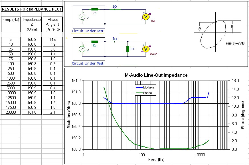

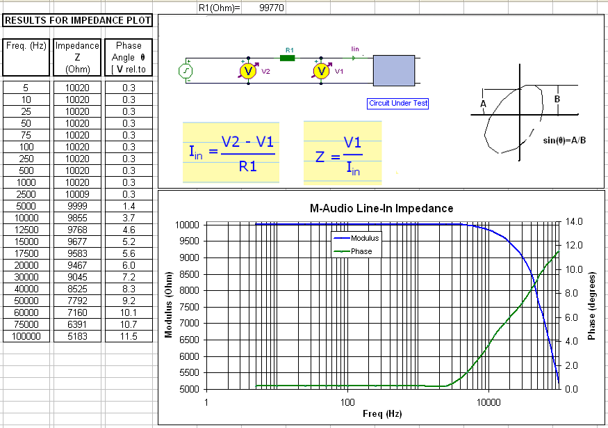

George,
Am I missing something, I don't see a load resistor on the right input to the shell (ground.)
You are right Ed. I haven’t placed any external load resistor, as the card’s input impedance is 10kOhm, see first attachment.
The card’s output impedance (signal source) is 150 Ohm, see second attachment
George
