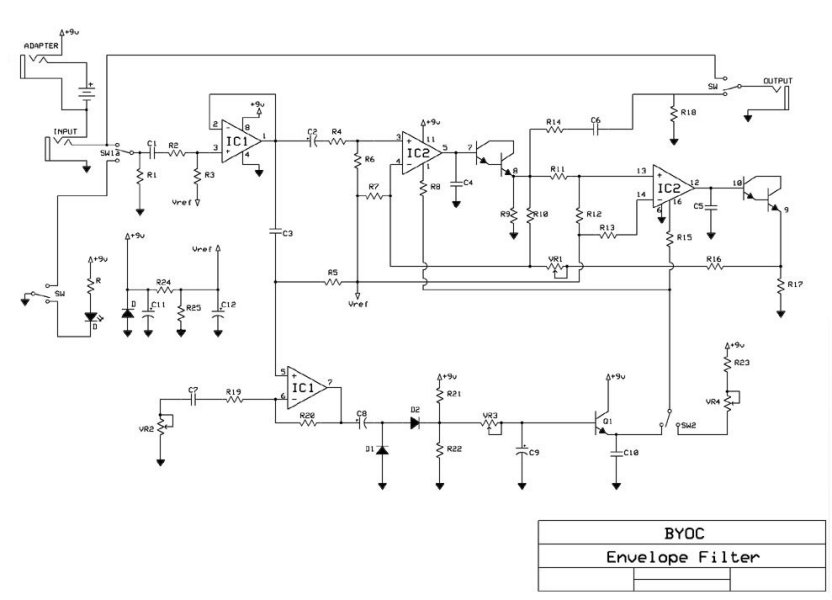

I don't think that's the right experimental model. Probably more like wiggling a tone control knob a little according to volume, but doing it fast enough that it's wiggling during one cycle of a sine wave.
If you wanted to use an envelope, an auto-wah circuit comes pretty close. The schematic below uses a couple of OTAs to implement the filter and an op-amp to rectify the audio to get the envelope.

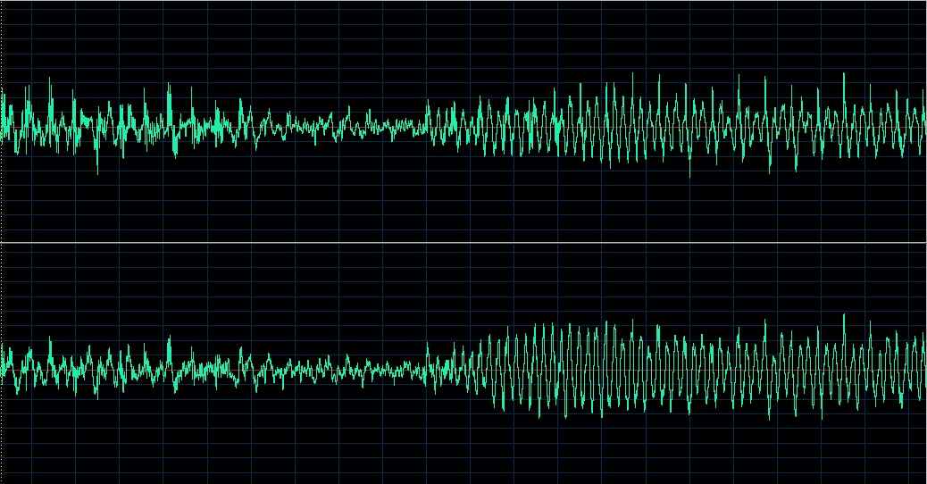

As for the experiment, no it's not clear. As a simple example the envelope of the sum of a 100Hz and 101Hz sine wave has a 1Hz component (worse yet it's technically multi-valued so not a function at all) so taking the envelope of the music is an extremely non-linear and/or an ambiguous operation. So you first have to show us what you consider the envelope of the music.
From now on these experiments should stated clearly with no ambiguity in any of the conditions.
What's the envelope of this...

The ICs in your attached schematic diagram are LM13700's.
