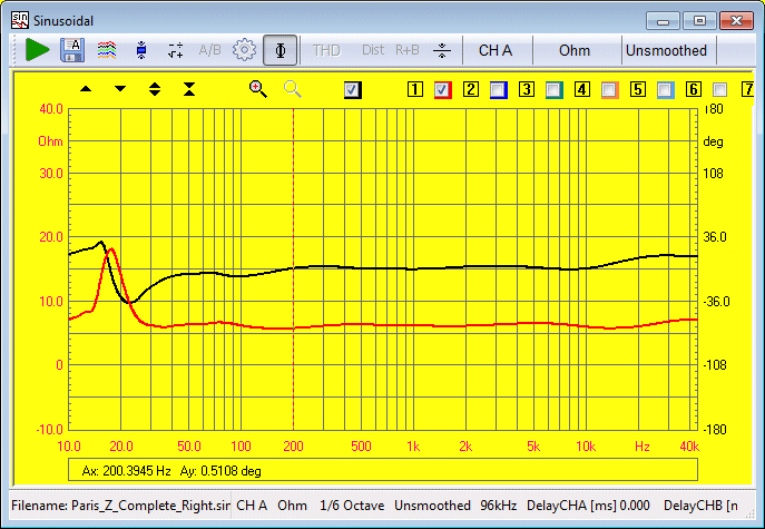

Guys, please have a look at the Elsinore xover here:
Elsinore Speakers DIY
Plse pay particular attention to the loop consisting of C1, L3 and C2. The depth of the short circuit this produces around 2.7 kHz will only be determined by the quality of the components used. It is bound to smoke amps.
Now please have a look at the graph on the linked site titled "Actually measured impedance and electrical phase angle". How can this ever be a measured result of a loudspeaker containing such a xover?
Because it is the measured impedance.
Many speaker designers will recognise that window as Audiomatica Clio System as used by professional designers. Like Roger Sanders, originally of Martin Logan fame. I spoke to him on the phone and we agreed that Clio is now the loudspeaker industry standard. But it can do a lot more than measure speakers. It can also measure electronics.
The above measurement is 100% real and correct, so I now must wonder if anything you say from that point on has a credibility at all, no validity, period.
Seems that in your haste you have drawn some really bad conclusions.
No commercial speaker has a more resistive impedance than the Elsinores.
There are plenty of people out there who have Elsinore Mk5 and Mk6 speakers, anybody that has access to them can do a simple measurement to assure that the impedance is extremely flat, in fact, I encourage builders to make it in order to be sure they have gotten the crossover right.

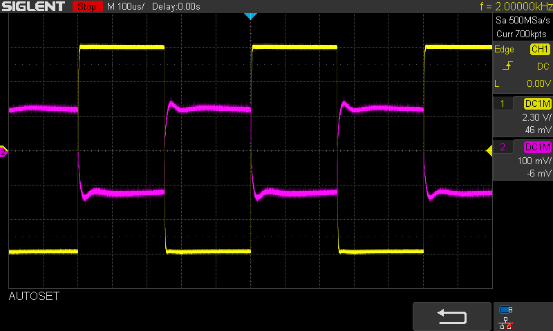

So really you owe me an apology and below you will see why.
Since that is a 2KHz voltage square wave and the current of the amplifier to the speaker is also a near perfect square wave.
This 2KHz current square wave is another proof that the impedance is flat from roughly a decade below and a decade above, from 200 Hertz to 20KHz.
A measurement like this does not lie, and you know it!
But I suspect you will not apologise despite the proof below that your hasty look at the crossover, you totally misinterpreted what it does.

Not sure about smokin' amps but I think you've been smokin' too much of that Amsterdamsky coffee shop weed. 🙂
For the tweeter network, which you are referring to, at 2700Hz I get about 25 ohms with a 6 ohm resistive tweeter load.
T
Thanks Terry. What went through his head I do not know. You are quite welcome to come here and supervise an impedance measurement that I can do on the Elsinore Mk6 here - and then report it to all and sundry here. I would love that. The thought did occur to me, what was he taking when he was looking at that. And couldn't he find a calculator (?) that should have been enough.
PS: Look at that 2KHz current square wave I posted, a few things happen when you get this kind of result, no reactive current from the amplifier and also effectively cancels out the output impedance of the amplifier. My current amps here are 2.5 Ohm to 5 Ohm and there is no change in the amplitude response of the amplifier. Why is that accepted as some kind of achievement, even a small one?
