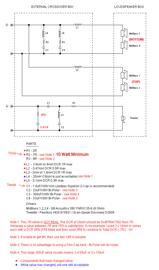

Guys, please have a look at the Elsinore xover here:
Elsinore Speakers DIY
Plse pay particular attention to the loop consisting of C1, L3 and C2. The depth of the short circuit this produces around 2.7 kHz will only be determined by the quality of the components used. It is bound to smoke amps.
Now please have a look at the graph on the linked site titled "Actually measured impedance and electrical phase angle". How can this ever be a measured result of a loudspeaker containing such a xover?
As to Scotts question: I would expect distortion to be pretty much like these drivers would produce on their own. With possibly a bump around 2.7 kHz if an amp can't deal with very low impedances.
C2>>C1 so C1 is the one that matters. A series resonator creates an impedance notch because the voltage at the junction of the C and L is boosted above the level of the input voltage in opposite phase (which is a mode of destruction in PSU LC filters and wherever else they are used). The impedance at that point is very high at the resonant frequency. Thus a resistive load at this point has a dramatic effect on the Q of the resonance. If the load is equal to the characteristic impedance of of the LC, then there is no resonance.
Most likely that is the case as otherwise, the output of the LC network would be a spike at the resonant frequency.
I don't think this crossover is dangerous, although if the tweeter goes open perhaps it could be.
That's a very strange way of looking at cause and effect. A series LC has a notch because Ls + 1/Cs = 0 at resonance. The Q is limited by any and all dissipative losses. The 1.8uF at 2.7kHz would be ~32 Ohms at 90 degrees probably not fatal.
True, but this is misleadingly terse in context. The level increase at the LC junction is always attendant with the impedance notch. You don't get one without the other. This kind of working knowledge is useful, but perhaps the way I presented it is strange.
If you think the same way as others do, you repeat their mistakes. So I am not too worried if it is strange, as long as it is correct. But I certainly don't want to confuse anyone, so don't let me get away with it if I am.
That's just the capacitive reactance, Vacuphile was worried about the resonance which, if the tweeter went open would be a dead short plus the inductor and speaker cable resistance. But this would be true for many crossovers currently in use.

Whatever works for you is fine. Given simply a resonant frequency there are literally infinite combinations of L and C but if one looks at the reactive impedance vs. the resistive loss you come up with a narrower range of values that make sense.
There are lots of cute passive circuits that give voltage gain but none can give power gain.

For the tweeter network, which you are referring to, at 2700Hz I get about 25 ohms with a 6 ohm resistive tweeter load.

Besides this, a major issue I see with these speakers is that they are bound to suffer from extreme beaming since the four mid bass drivers are placed in a large array with shallow xover curves. The mid to high transition region will be particularly exciting, beam wise, because of the large distances between the top three drivers in a d'Appolito configuration. I'd love to see horizontal and especially vertical polars.
Mid Bass speakers 3 / 4 won't beam, they are crossed pretty low, from the look of it around 600 or so.
MB 1 and 2 are crossed pretty high. I'm not familiar with these drivers HF performance, maybe Joe can comment on this.

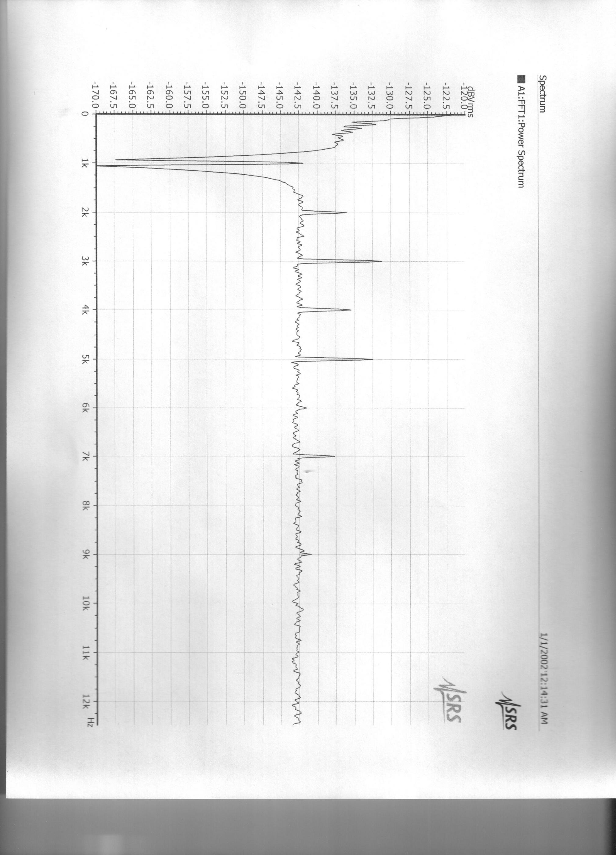

This is the 1KHz distortion residual measured today with my SR-1 analyzer. How can I get even lower, without new test equipment? Anybody?
I take it this is the analyzer looped to the internal signal generator. First question is how does it vary with level? I suspect it is best at somewhere near maximum output. So an external attenuator may be needed to get desired test levels.
Now if this is the test signal used, if you do amplitude and phase FFTs then a baseline to output comparison will give you some insight even if not absolute numbers.
Next step is to build tuned twin T filters for each harmonic and test for one harmonic at a time.
