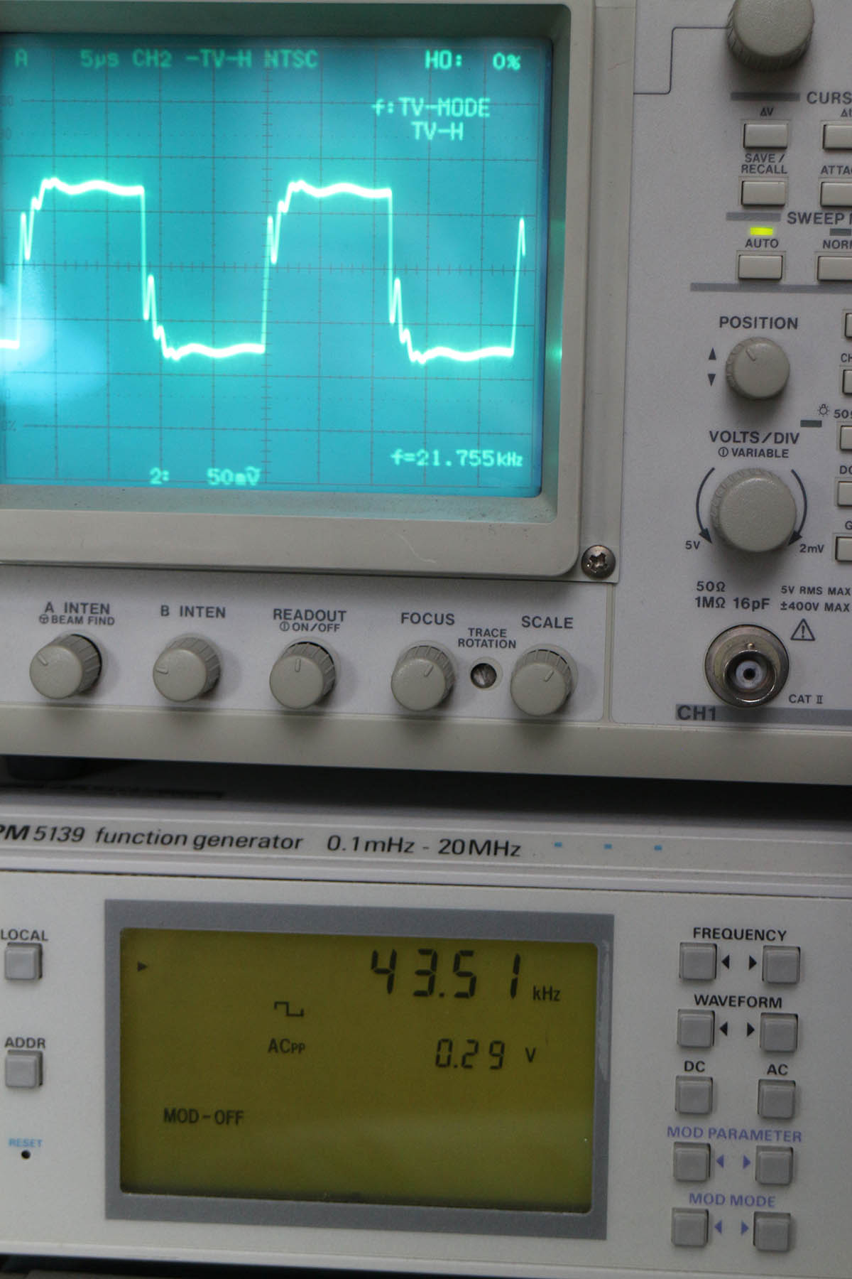

Square waves are revealing. I was toying around with putting an LM3886 in a loop with a low distortion opamp, like in Scott's article, also looking at Bob Pease's article and the Neurochrome implementation.
It is possible to lower distortion that way, but a 40kHz square wave revealed behaviour I haven't seen before:

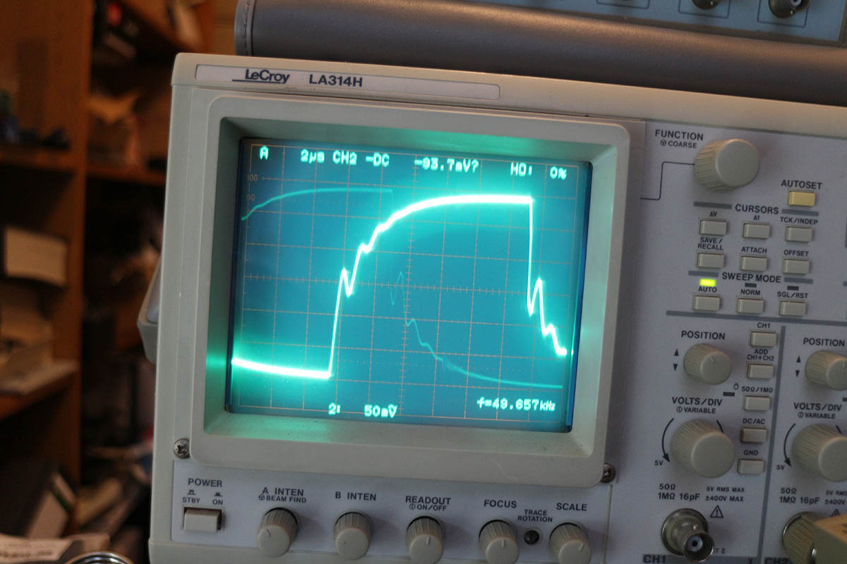

So what is happening here? It seems to be inherent to the topology. Neurochrome's, optimized implementation shows the following:
It looks like that when rise time exceeds a certain limit, it sets off an oscillation. I was thinking about propagation delay perhaps, but those seem to play out at an order of magnitude shorter in duration. I hope Scott or someone else can help me out here understanding this phenomenon.
Now, the other question I would like to bother you with is the following. My dead bug version more than halved distortion compared to a bare 3886, with no attempt at optimization. Neurochrome has measured distortion of just 0.00065%. So, there is a lot to gain in that field.

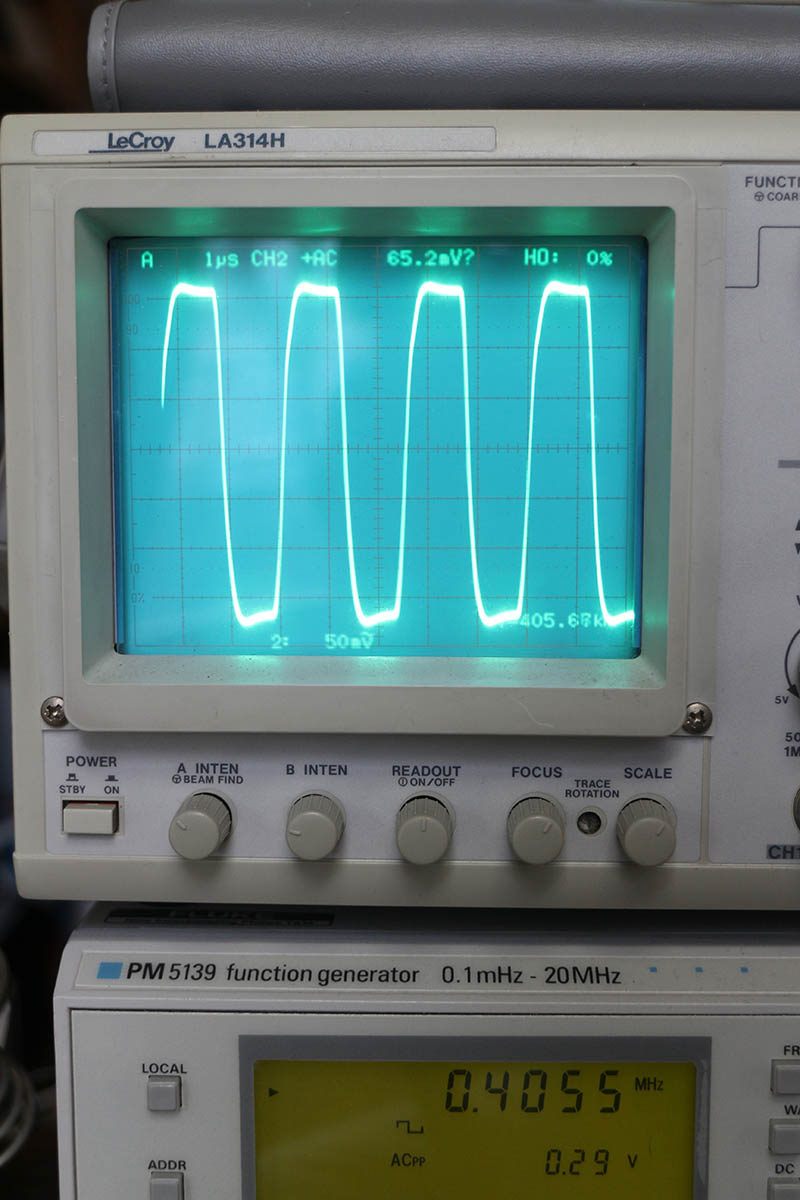

However. This is a picture of a bare LM3886 at 400 kHz, ten times faster than the other two measurements:
Question: Looking at these results, what is the best amplifier? The one with the lowest distortion, or the one that doesn't misbehave on high speed transients?
