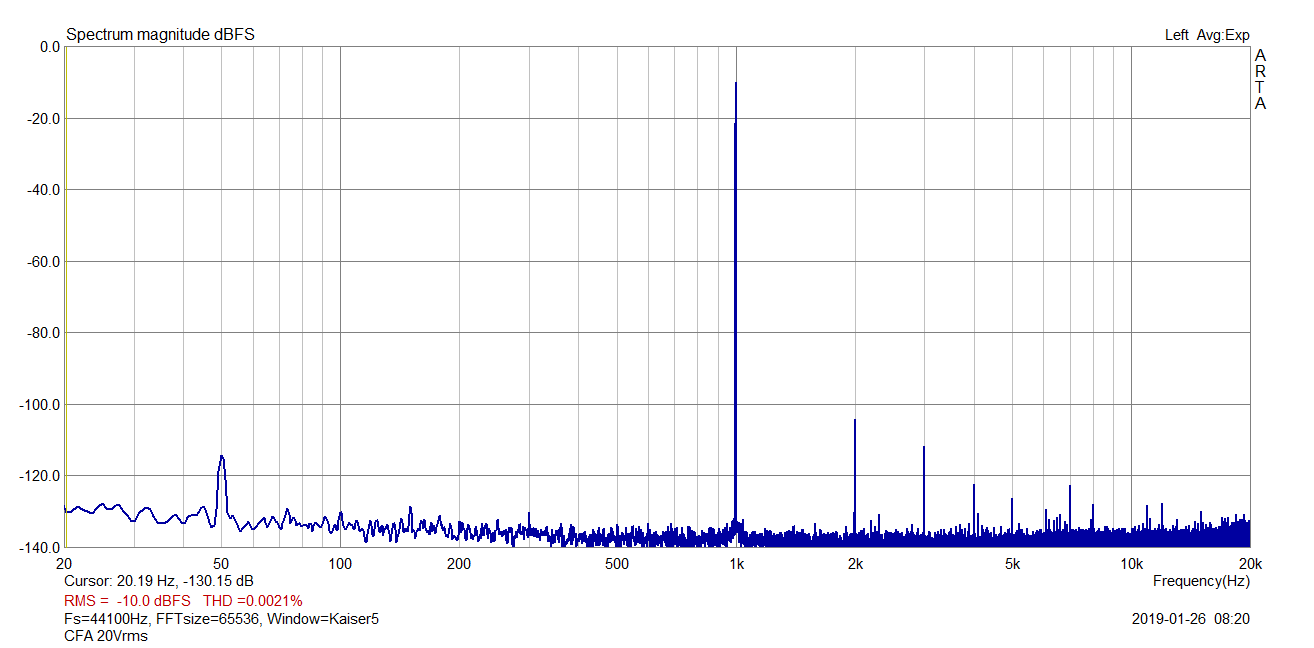

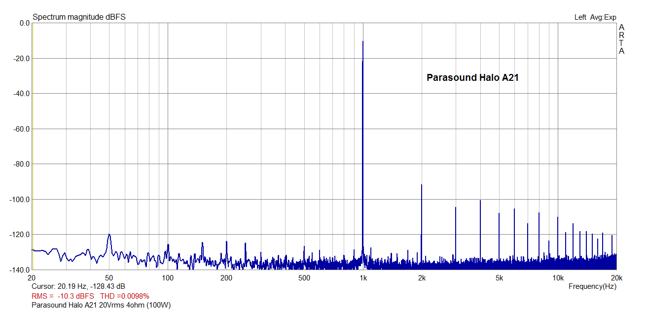

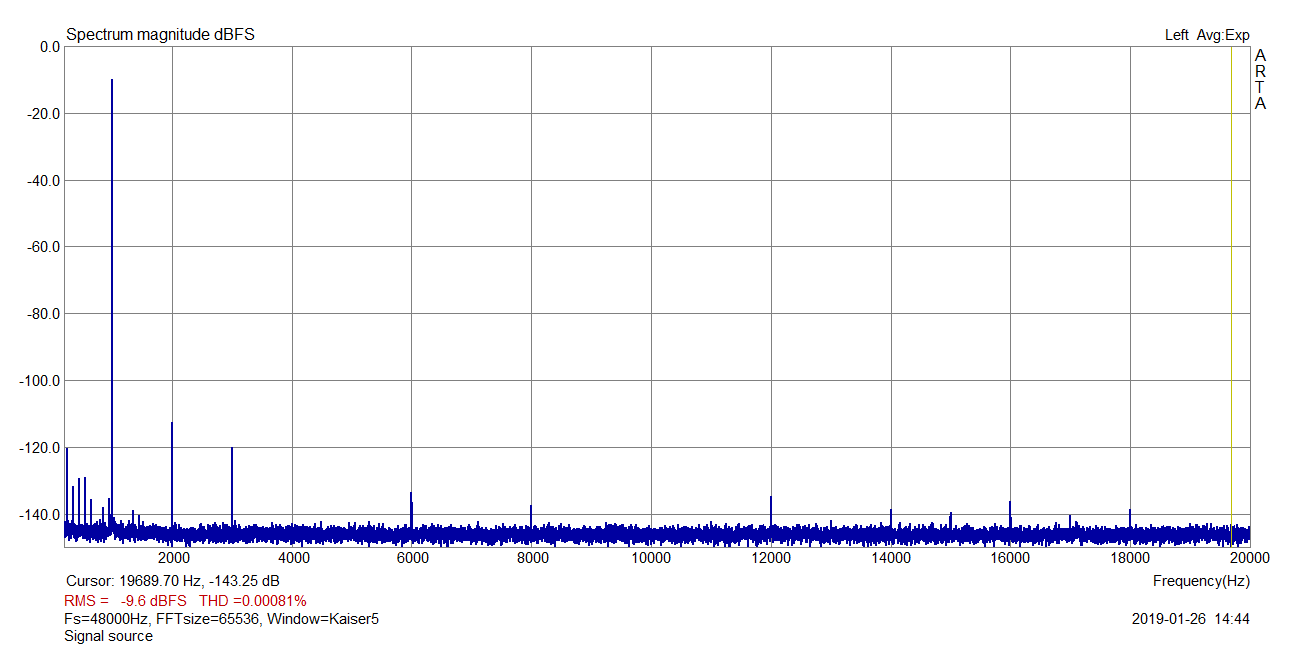

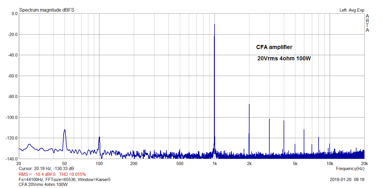

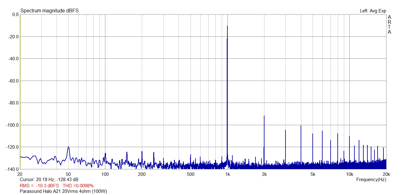

Just to make sure that the high order harmonics are really not the case of the measurement system, I made a comparative measurement at 20Vrms with another amplifier, with exactly same measurement system and settings as for A21 before. Both measurements shown.

PMA, I do think that your measurement of the A21 is OK, BUT what about the bias setting?
Is it below 15mV? If it is, then rebias it. If it isn't below 15mV, then what do you suggest that I change to improve it? I do realize that the driver fets are somewhat underbiased compared to many other Parasound power amps that I have worked on.
Do you think that is the source of the VERY HIGH ORDER harmonics that you measured? That can be changed with a resistor value lowering.
Do you still have access to this A21? Perhaps I am asking too much. I would certainly like to fix the amp if I can. Perhaps I gave up on improving it prematurely.
No, you are not asking too much. But, unfortunately, the A21 is not here in my lab now. It was here for just one day, last week, together with 2 other components of its owner. So, I am not able to answer your technical questions.
Though I cannot confirm or deny how big was the idle current, my suspicion is oriented to that measurement of THD vs. frequency. You could see that it was quite linearly rising with frequency. I suspect that feedback has not enough gain to reduce high order harmonics, seems to me that OLG corner is low, somewhere at 200Hz. Do you have an idea where it is?

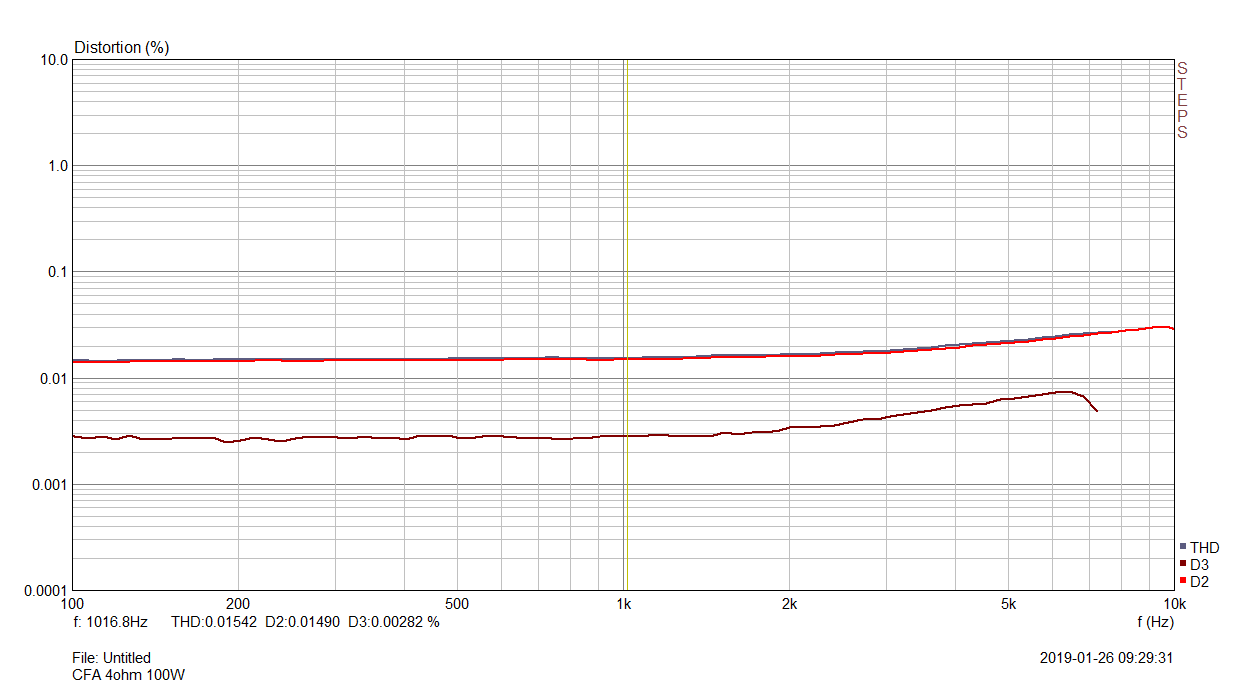

I have also measured, today, one of my older prototypes of the CFA amplifier. It has only a little more than 100W/4ohm maximum power. I measured it at 100W/4ohm, same as I did with A21, but for CFA, I was almost at the power limit. However, higher harmonics decay is faster, than for A21. Please also see THD vs. freq of that CFA, the plot is amost flat, OLG is quite high.

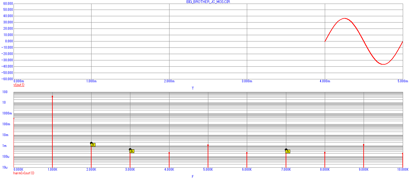

Years ago I simulated a very similar amplifier with the MOSFET drivers, like in A21. I was thinking about using the MOSFET drivers instead of 15030/31. But, the simulation result was full of high order harmonics, for higher power. Idle current is 85mA per pair, there are 4 pairs like in the A21. 19mV across one Re output stage resistor ......

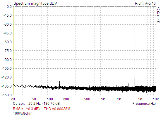

My amp ,bipolar, (3EF, 2pairs Sanken´s), bias about 15mA per transistor.. For power from 100mW to 100W it looks very similar (THD and CCIF).
