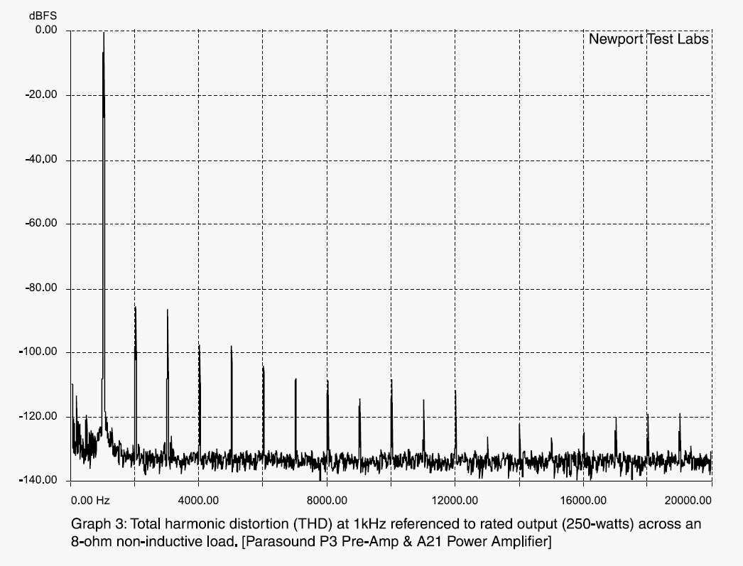

Interestingly, there is a review of the A21 that was published in Australian HiFi Magazine, about 10 years ago, author Steve Holding. They measured at 250W/8ohm and the spectrum is very similar to my 100W/4ohm measurement.

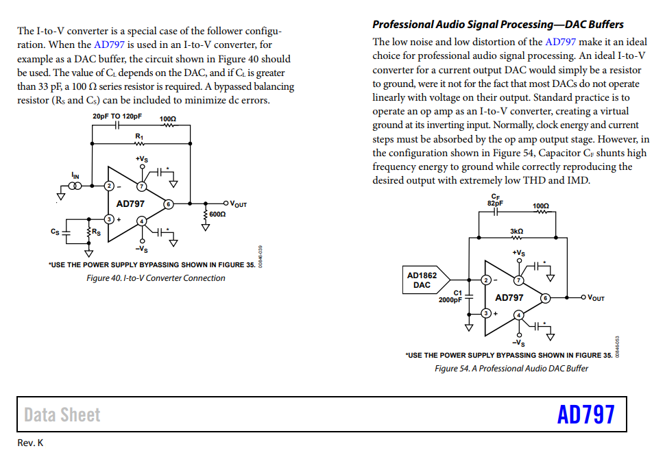

Thanks Scott.I presented my alternative (even Thorsten L. liked it).
You suggested the shunting to ground input capacitor C1 as a general solution regardless of the particular opamp IC.

Each op-amp might have slightly different values depending on their GBW product but the principle works for any of them.

Yes, IIRC Mr. (Dr.?) Small claimed that he gave this idea to Phillips around day one. When I pointed out that the 5534 has a high output impedance at RF and the cap stops working he would have none of it. I presented my alternative (even Thorsten L. liked it).
I'm using a similar trick with the ESS DAC's pretty successfully. With a differential out DAC you can bridge a cap from plus out to minus out on a current out DAC. The ESS dacs clock at up to 100 MHz so its a safe bet that no audio grade opamp will keep up with any glitch energy.
When you say 'sucessfully' does that mean you have measured reduced distortion with a particular value cap?
I'd probably qualify success in this case as not increasing distortion while reducing common-mode high frequency components.

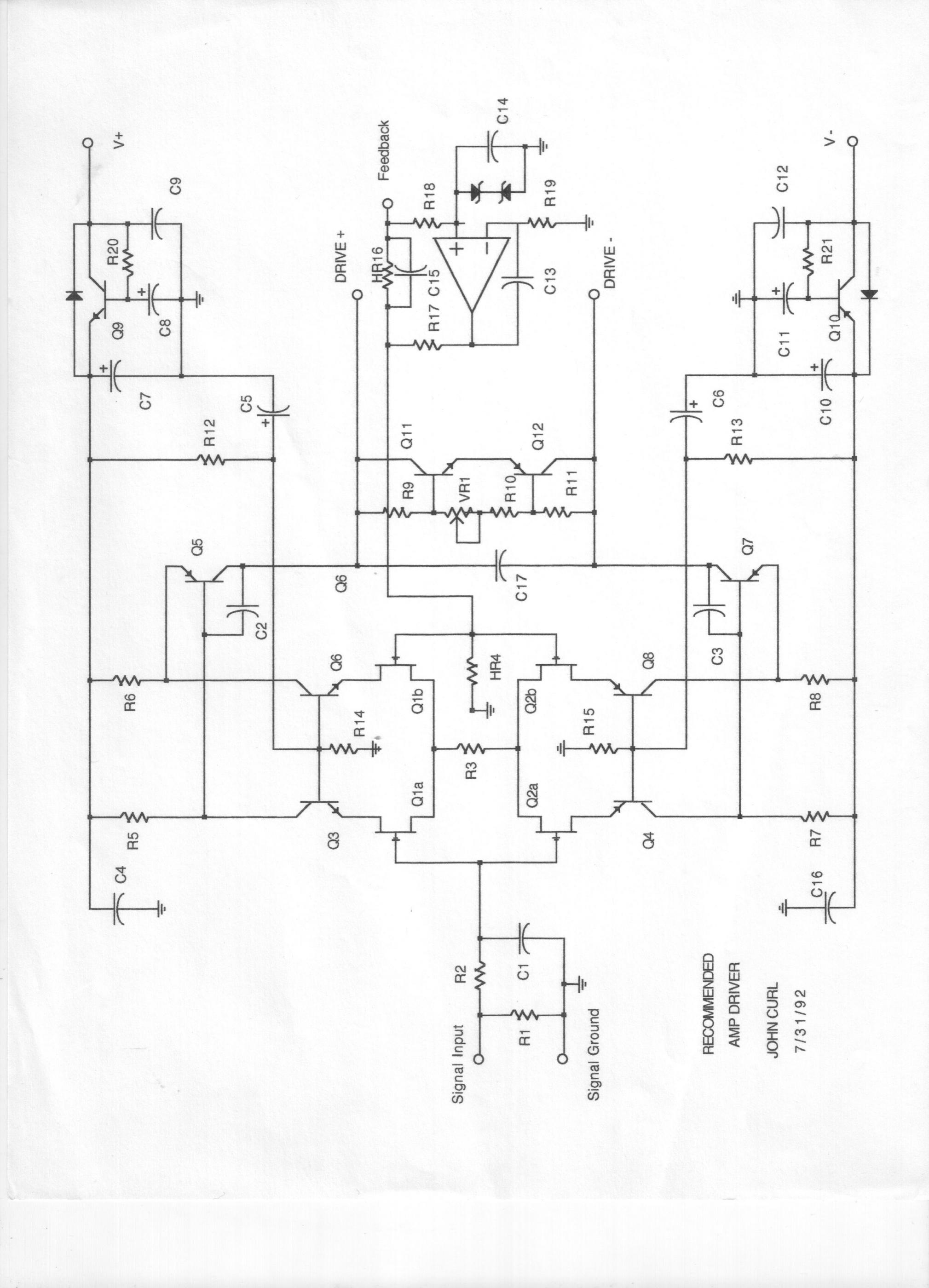

For further discussion, this is the template that I made 26 years ago for Parasound to follow for the less expensive power amps. The A21 follows this template fairly closely.
Thinking back I misunderstood, it would do nothing to common-mode signals if it's across the outputs.
If things like clock feedthrough are not differential mode, it might not be very helpful.

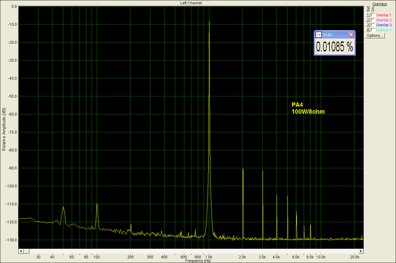

About 10 years ago I built an amplifier, which is in fact based on John Curl's topology. Several pieces were built within 1 year that time and they still work well at their owners.
PA4 power amplifier

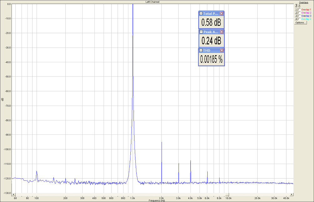

I do not have exactly same measurements, from that time, as I have made yesterday on A21, however the old plots show much faster decay of high order distortion components. Yes, it was loaded with 8ohm, but even with 4ohm it was not too different, as I remember. I agree that quiescent current is important, my was about 100mA per pair. 4 pairs, so it was about 0.4A. 0R22 emitter resistors.
The high orders shown that time and yesterday are not measurement residuals, they are just there in the measured subject. Remove load and high orders are gone.
I think that in case of A21 it may be a case of loopgain frequency response. I also posted a THD vs. frequency at 10W yesterday and one can see that the distortion gradually rises with frequency. So there is not enough FB to reduce high order harmonics in the A21, though their origin is in the AB output stage and maybe low quiescent current.
PA4 power amplifier

Well PMA, we won't know what the distortion is in your measurements, unless you measure across one of the emitter resistors and find at least 15mV. More like 22mV might be more optimum, but I doubt that the heatsink can support it without getting too hot.
However, the Australian measurement, made a decade ago, MIGHT be putting in the extreme hi harmonics from the test equipment residual. If you can offer any suggestions, I would appreciate it. I do realize that the A21's fet driver is starved somewhat, but I tried to change the value and it did not help much.
I think you could read from my post that I had 22mV per one Re resistor. I wrote 100mA and 0R22, this makes 22mV 😉. My measuring system had <0.001% distortion, H2 and H3, free from high order distortion. I think this is a nit-picking. You can see a measurement of another amplifier, into 4ohm, free of high order harmonics. It has a 3EF output stage and multi-pole feedback, that is much more effective in distortion reduction. Still not as good as class A. The A21 has high order distortion components when asked to give some power. This may be a result of either underbias, or non-optimal feedback action which is not able to reduce higher harmonics because of decreased loopgain at higher frequencies. This is normal and usual. I do not think that Australian measurements had inherent high order harmonics in the system. It rather sounds like an excuse, to me.
