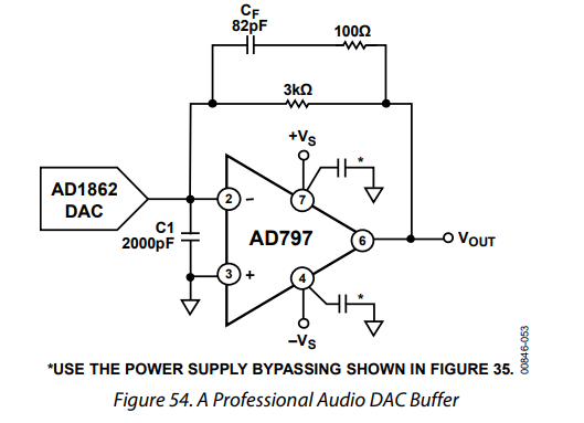

Depends what you mean by 'evaluate.' It isn't a new idea, actually. He is trying to reduce HF clock noise from some low cost current output dac chips so it doesn't cause too much distortion in I/V opamps. It likely works about like he says. Not something applicable to ESS Sabre dacs though, since it would increase distortion with them.
Understatement, they told me I was wrong. Dick was there, it was a LONG time ago. IIRC it was Small of Thiele-Small that said a 5534 with the 2000pF cap was all you need, nothing else would make a difference.
It's an implementation of a passive filtering scheme.
This HF noise has been written is what makes opamp ICs unsuitable for the task (while discrete implementations survive )

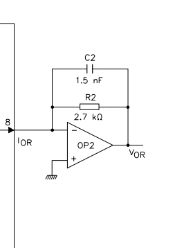

You mean C2 ?

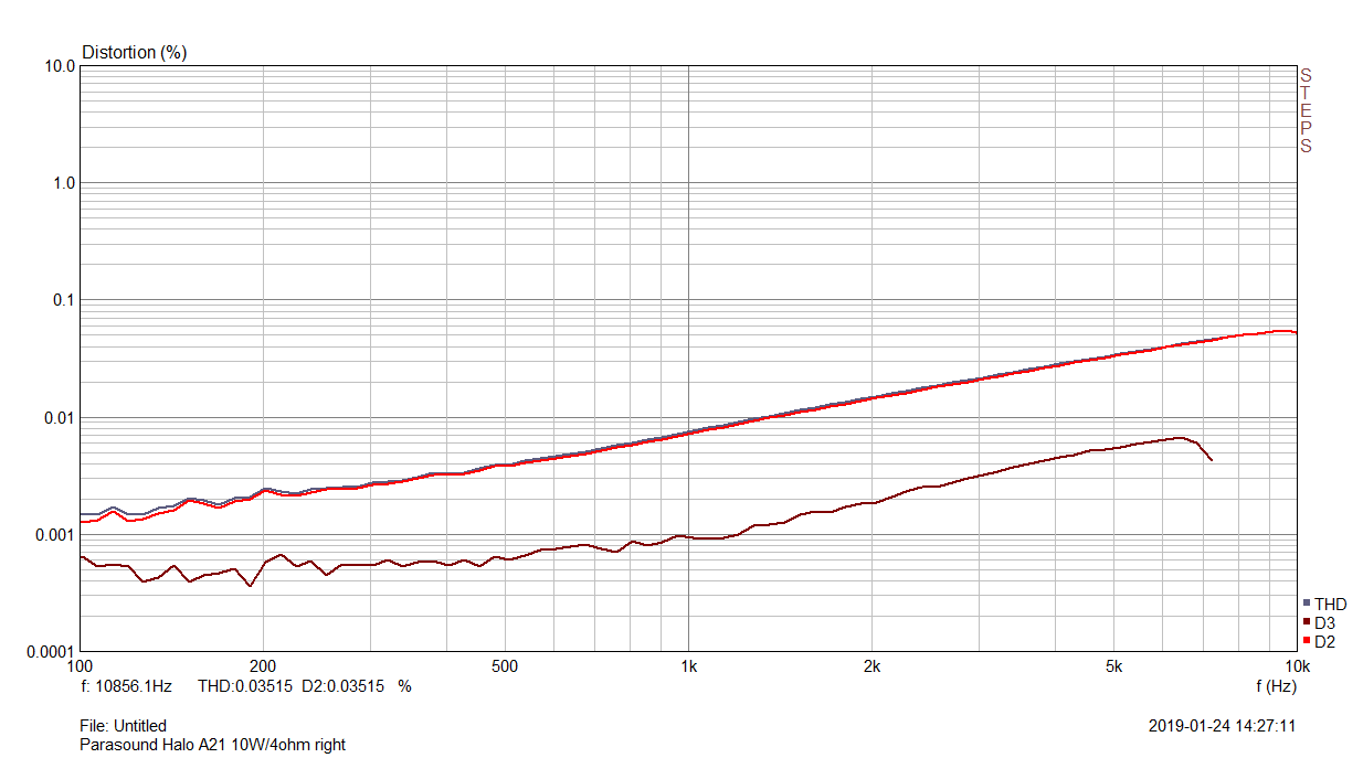

Now regarding Halo A21 power amplifier, my comments:
+ points:
- high power, it meets power specs, 400W/4ohm
- it meets most of the specs as shown at Parasound web and datasheet
- very good dynamic range
- points:
- though distortion is quite low, the distortion spectrum has a lot of high order harmonics that are slowly decaying. This might be a problem in the VAS or the driver circuit of the output pair? Please see measurement at 1kHz/100W/4om.
- distortion rises with frequency quite too much to my taste. Please see measurement of THD vs. frequency at 10W/4ohm.
You mean C2 ?
George
Yes, IIRC Mr. (Dr.?) Small claimed that he gave this idea to Phillips around day one. When I pointed out that the 5534 has a high output impedance at RF and the cap stops working he would have none of it. I presented my alternative (even Thorsten L. liked it). I ended up mentioning that I had no problem with folks that prefer SET's and horns and all hell broke loose (not quite) 😉.

I agree PMA, the A21 is relatively lousy at 4 ohms and below. If you can suggest something that will fix it with the same number of parts, I would gladly fix it. Into 8 ohm loads it is OK. This is why I gave my A21 to my associate, and waited for the JC-5 to change my amp.
