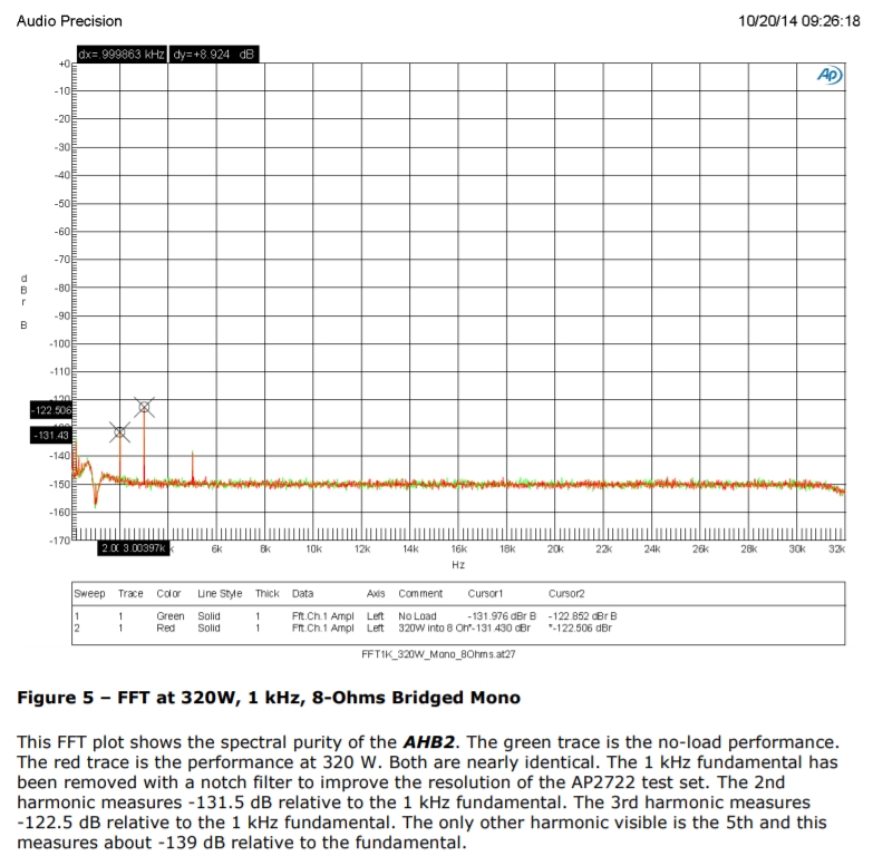

Dunno. Haven't seen a graph for that, but there are detailed specs under the specifications tab here: Benchmark AHB2 Power Amplifier - Benchmark Media Systems
... and in the manual here: https://cdn.shopify.com/s/files/1/0321/7609/files/AHB2_Manual_-_Rev_G.pdf?6581480924542235084
Looks like it says: < 0.0003 % THD+N at full rated power, 20 Hz to 20 kHz for all rated loads
Such as: 240 Watts per channel into 3 Ohms, both channels driven
Of course, it looks better at 1kHz (but they use a 20kHz LPF for that measurement)
Some more measurements here: Benchmark Media Systems AHB2 power amplifier Measurements | Stereophile.com
If I could get a lower distortion power amp for around the same price, I would probably want one.
